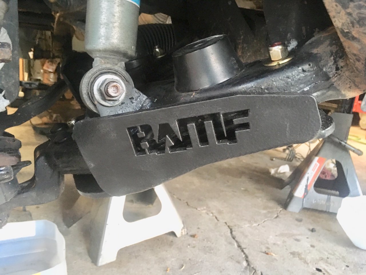

    I snagged the last pair of BAMF 1st gen LCA skid plates. They're going to look a little odd next to the stock tinfoil skids, but the time was right to install them. BudBuilt front and mid skid plates are on the way.

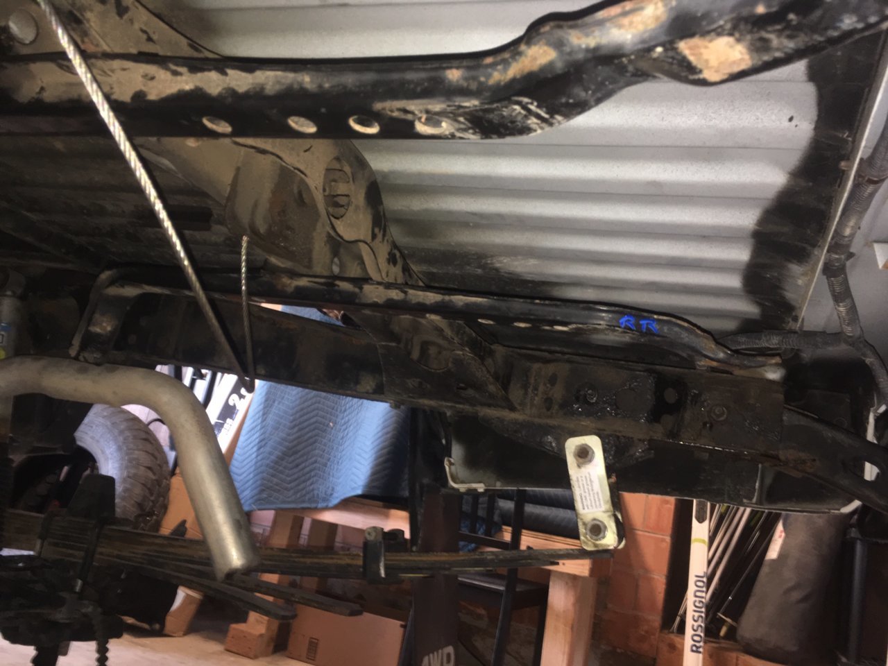

    Dr. Strangelove or: How I learned to stop worrying and fit a 33" tire in the stock spare location. Just bend the rearmost tabs out. Then it fits without being any closer to a hot tailpipe than the old spare.

    Did you need to heat them up to bend ?

    No, I bent them back in a bench vise.

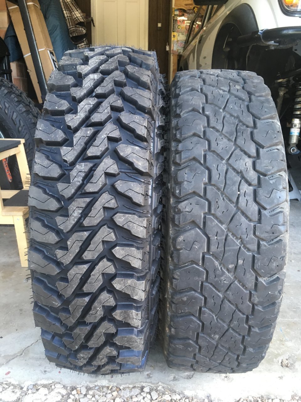

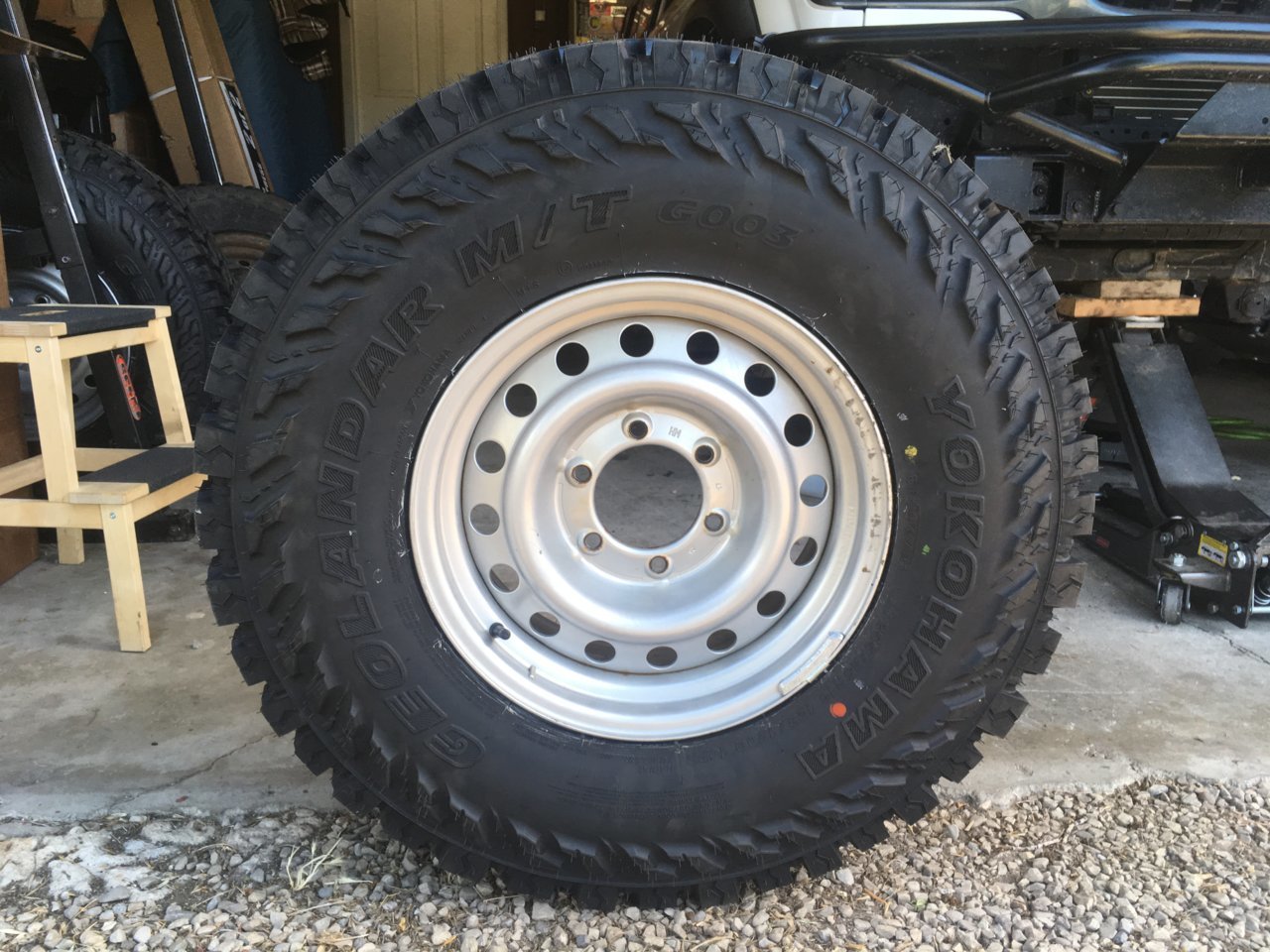

    New 255/85r16’s vs old 235/85r16’s
