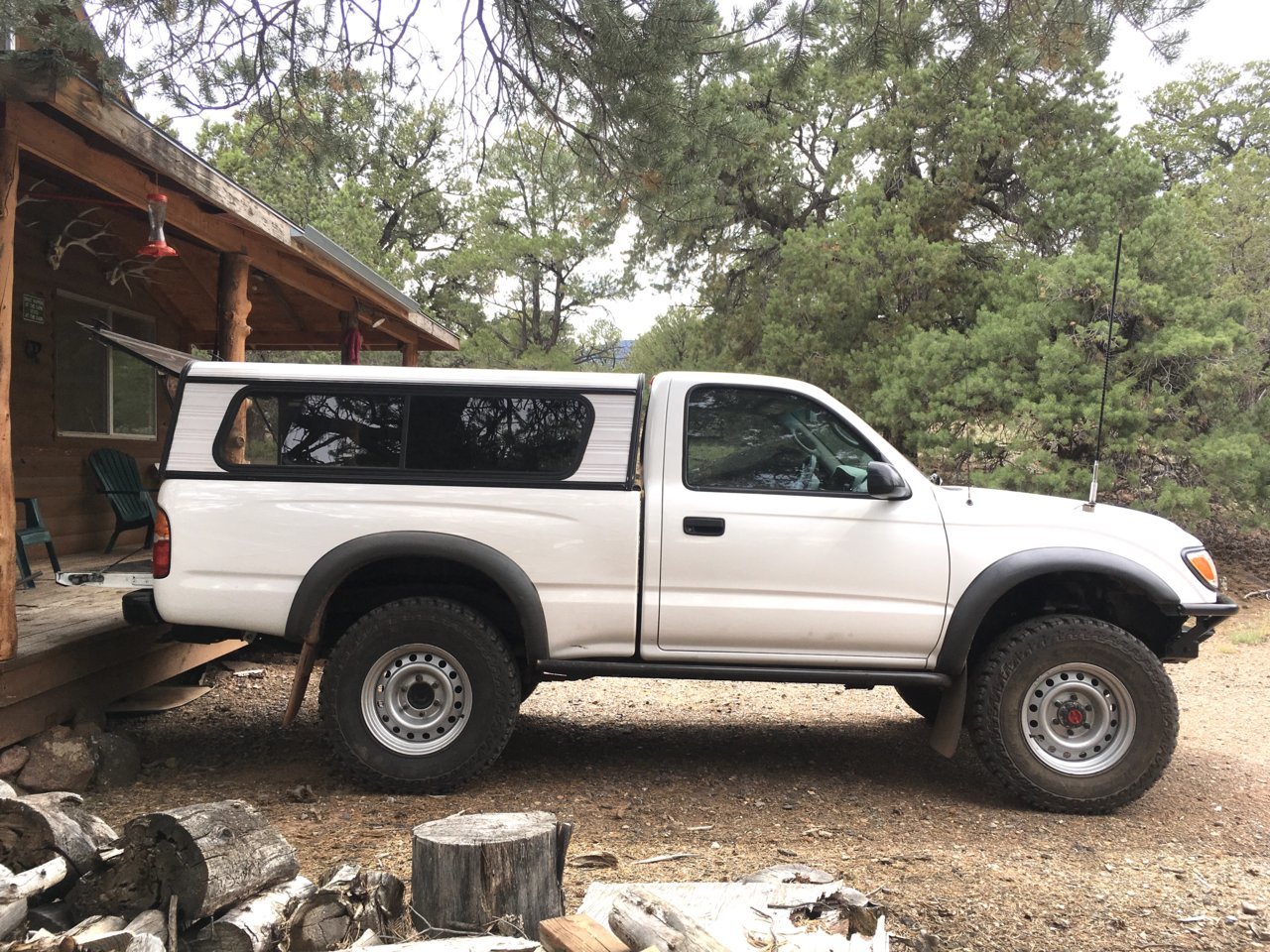

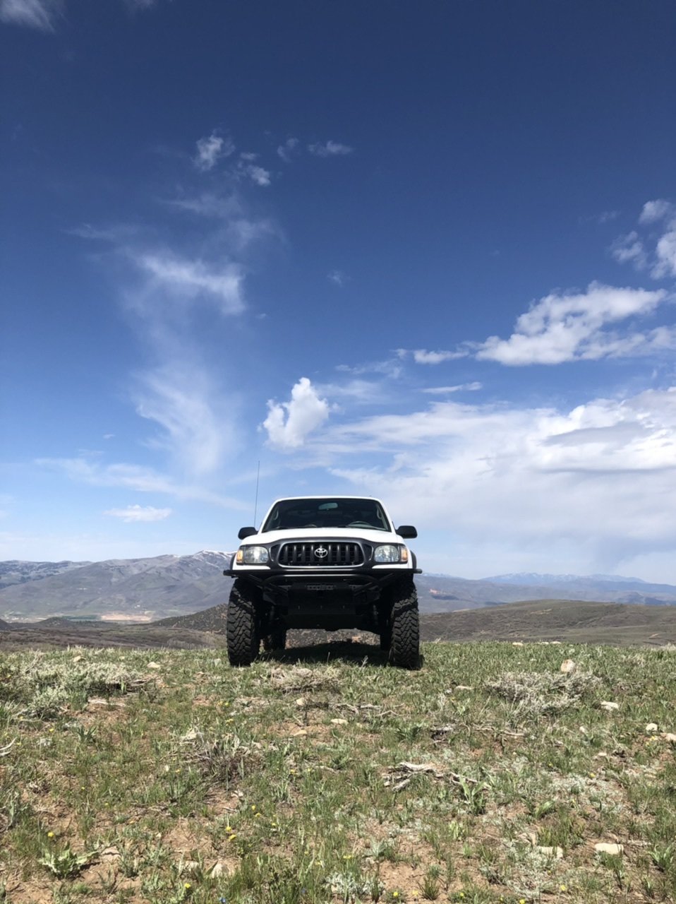

    Thank you very much, @Tacoscar-the-grouch. I’m glad I’m not the only one who loves these little utilitarian beasts.
    I had already installed the high clearance front bumper and relocated the wiper reservoir when I had 235/85R16’s. I also already had SPC upper control arms before I jumped up to 255/85R16’s. Then when I got the bigger tires I just had an alignment shop center them in the wheel wells by adjusting the lower control arm cam tabs and correcting the caster with the SPC uppers. The SPC’s have camber and caster adjustments that other aftermarket UCA’s do not.
    The 255’s rub the frame a bit at full lock but don’t hit anywhere else. If you want minimal mods, you could just run 235/85R16’s. They didn’t rub anywhere on my truck even when it was stock, and mounted up I don’t think they look smaller than 255’s.

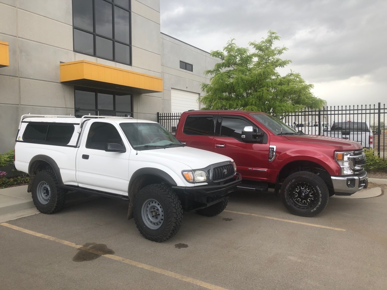

    My truck next to my coworker's new short bed F350.

    I still like the white one :burnrubber:

    Me too. Though if the F350 was a white poverty spec trim level with steel wheels, skinny tires, locking rear diff, vinyl flooring and no chrome, I'd be slightly envious.
