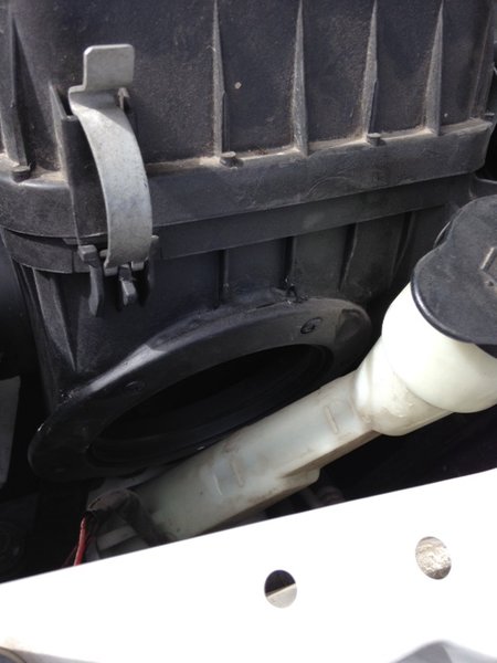

    So I did the deckplate mod about 6 weeks ago and I'm quite happy with the results. The hardest part was getting the hole as far into the upper left corner in order to clear the wiper fluid reservoir filler neck. Still, it only took about a half-hour to do everything. It makes an audible but not intrusive growl that reminds me very much of a vintage British sports car. I've used 5 tanks of gas since I got this truck in August and here is my MPG:
    Tank 1: Shell 91 octane, 90% city, 10% hwy, pre-deckplate: 20.85 MPG
    Tank 2: Shell 91 octane, 10% city, 20% off-road, 70% hwy, pre-deckplate: 21.10 MPG
    Tank 3: Shell 91 octane 85% city, 15% hwy, deckplate open: 22.95 MPG
    Tank 4: Shell 88 octane 70% city, 10% off-road, 20% hwy, deckplate open: 22.85 MPG
    Tank 5: Sinclair non-ethanol 88 octane: 70% city, 10% off-road, 20% hwy, deckplate open: 24.65 MPG
    Tank 6 is Shell 91 octane again but I will definitely be using non-ethanol gas whenever I can find it. I have not been trying to get good MPG either, because I like that vintage British sports car intake growl. When the novelty wears off, I will try to drive carefully for an entire tank of non-ethanol fuel just out of curiosity to see what kind of MPG is possible. I'm already chuffed on the results, the MPG is better than I used to get in a 2wd I4 Ford Ranger with 50 less HP.

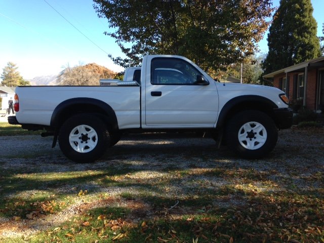

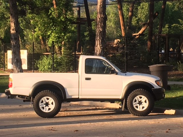

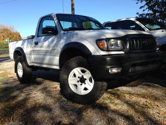

    So I discovered that the 235/85's were after all rubbing the frame a bit at full lock, due to the 5.25" backspacing on 2nd gen OEM wheels. The solution for me was a set of 3rd gen 4runner alloys which have 4.6" backspacing and quite a bit less weight than the steelies. I had to rattle-can them because it's time for white wheels to make a comeback:

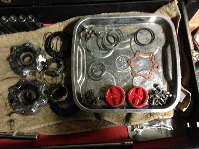

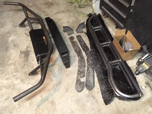

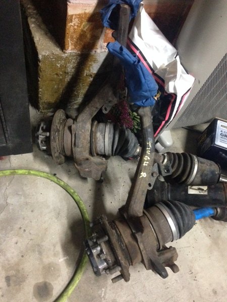

    Now I have to find the motivation to disassemble the entire front end, tear out all of the ADD shit and install these bad boys:

    First of all, the white is so cool its ridiculous!
    I also had an issue withbthe 235s and the 5.25 backspace. Went to a 4.75 bs rim and I'm set now

    How'd it go converting to manual hubs? You have to replace the axle tubes and axles as well correct?

    Hello @98tacoma3rz, I haven't done the manual hub conversion yet, I'm lazy.

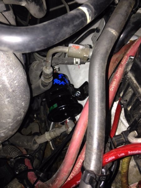

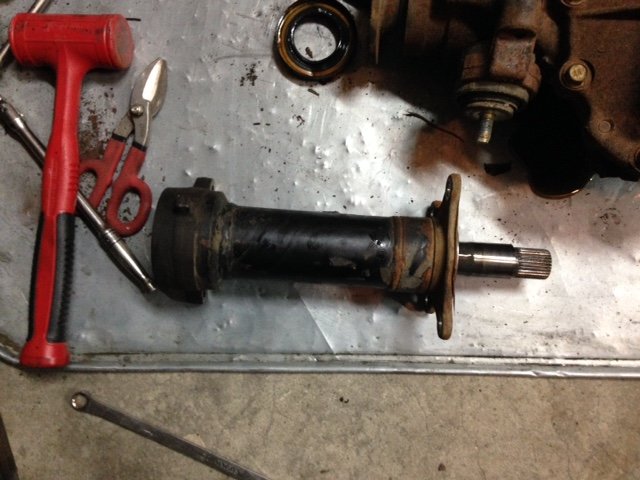

    -Relocated fuel filter from PITA location under intake manifold to logical location on fender well:
    The Cooper ST Maxx's I bought from @ikarus have about 15,000 miles on them now and still look new. I have had them on for 4500 miles without rotating them and the fronts are showing no more wear than the rears. We had a snowy winter and the traction was excellent. Spring has been pretty rainy and the 235/85r16's cut through standing water like, well, pizza cutters. They are the most secure-feeling tires I've ever driven in snow and rain.
