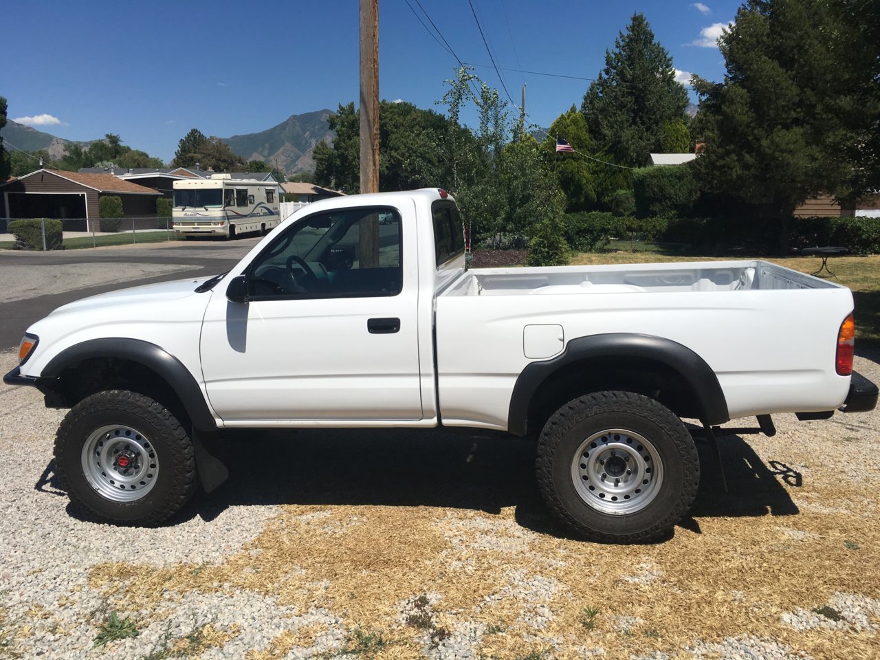

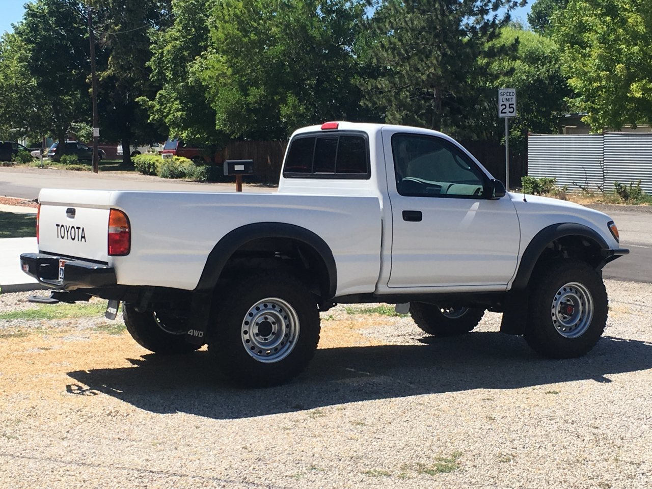

    It's been awhile since I've updated anything but single cab Toyota pickups still fill my heart with throbbing lust. I found some steel wheels on local online classifieds at a too-good-to-be-true price and they turned out to be professionally refinished hub-centric OEM wheels with 4.7" backspacing, perfect for a 1st gen with 235/85r16 pizza cutters. Thanks, internet!

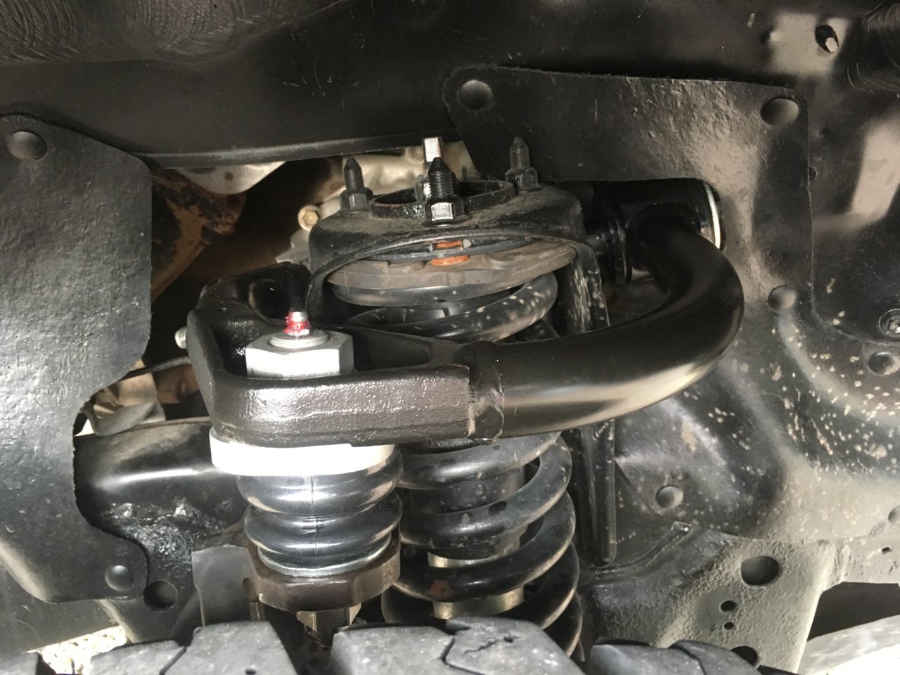

    Brown Santa dropped off new upper control arms today. The OME 880 coils I installed about this time last year have never settled, so I've been driving on an out of spec alignment. Time to rectify that.

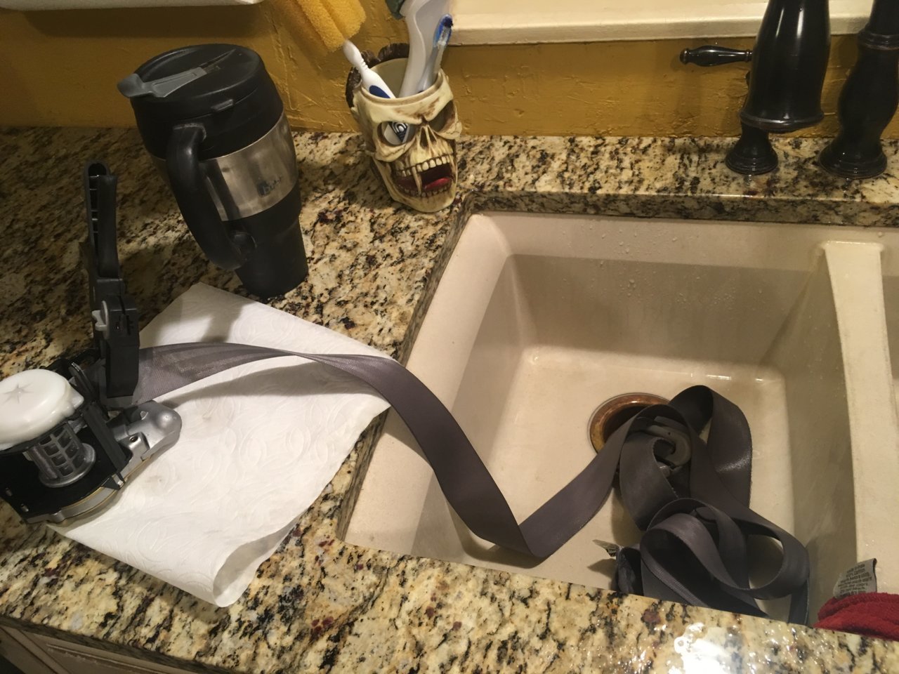

    I got my new SPC upper control arms in. It was a mostly easy install with a 3 jaw puller to pop the old upper ball joints off the stock UCAs, some abuse of a rental ball joint press to get the ball joints of unknown age out of my second-hand manual hub spindles, and copious amounts of forehead sweat in place of PB Blaster. The most bad words I had to use were getting my grease gun primed with new grease for these bitchin' greasable upper ball joints.
    I was still amped on high-octane iced coffee so I finally dealt with the constant low-level annoyance of lazy seatbelt retractor syndrome. I pulled them out, blew out the retractor mechanisms with compressed air, lubed the retractor mechanisms with WD-40 silicone spray, and washed the seat belts thoroughly. Much better now. Let me tell you how much my wife loves it when I bring garage projects into the kitchen sink...

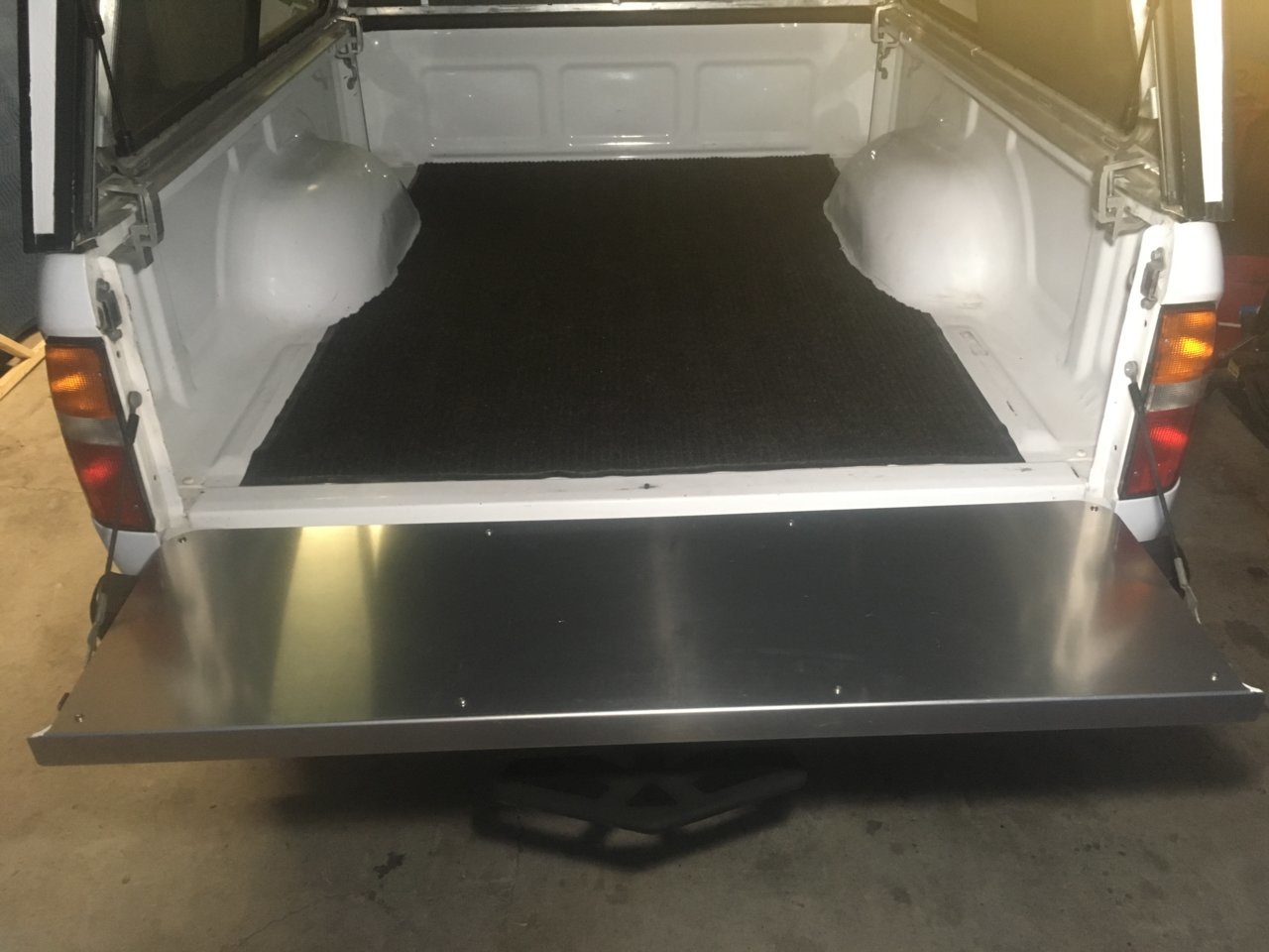

    Out of all of the bitchin' modifications on the @Jiveydude -mobile, I was the most envious of his Relentless Fab tailgate reinforcement. Mine arrived today in unfinished aluminum, just the way I wanted it. It won’t be this pretty for long...
