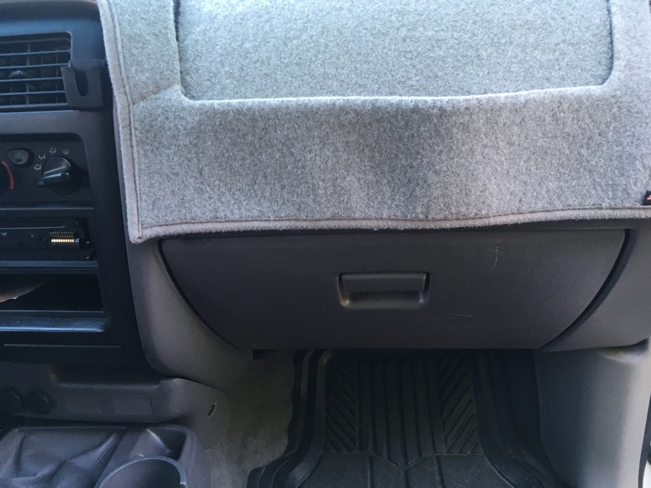

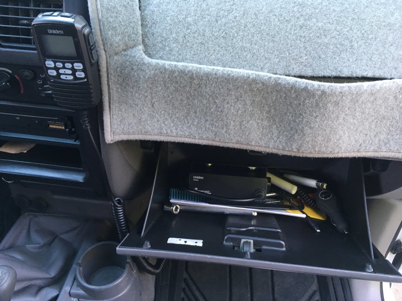

    CB is installed. Now you see it:
    Now you don’t:

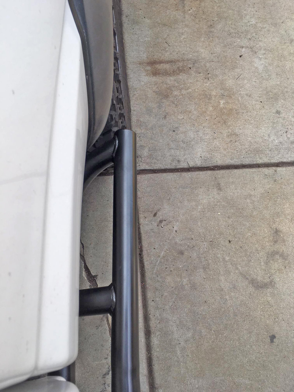

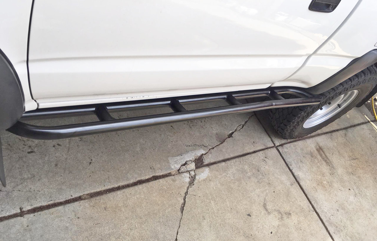

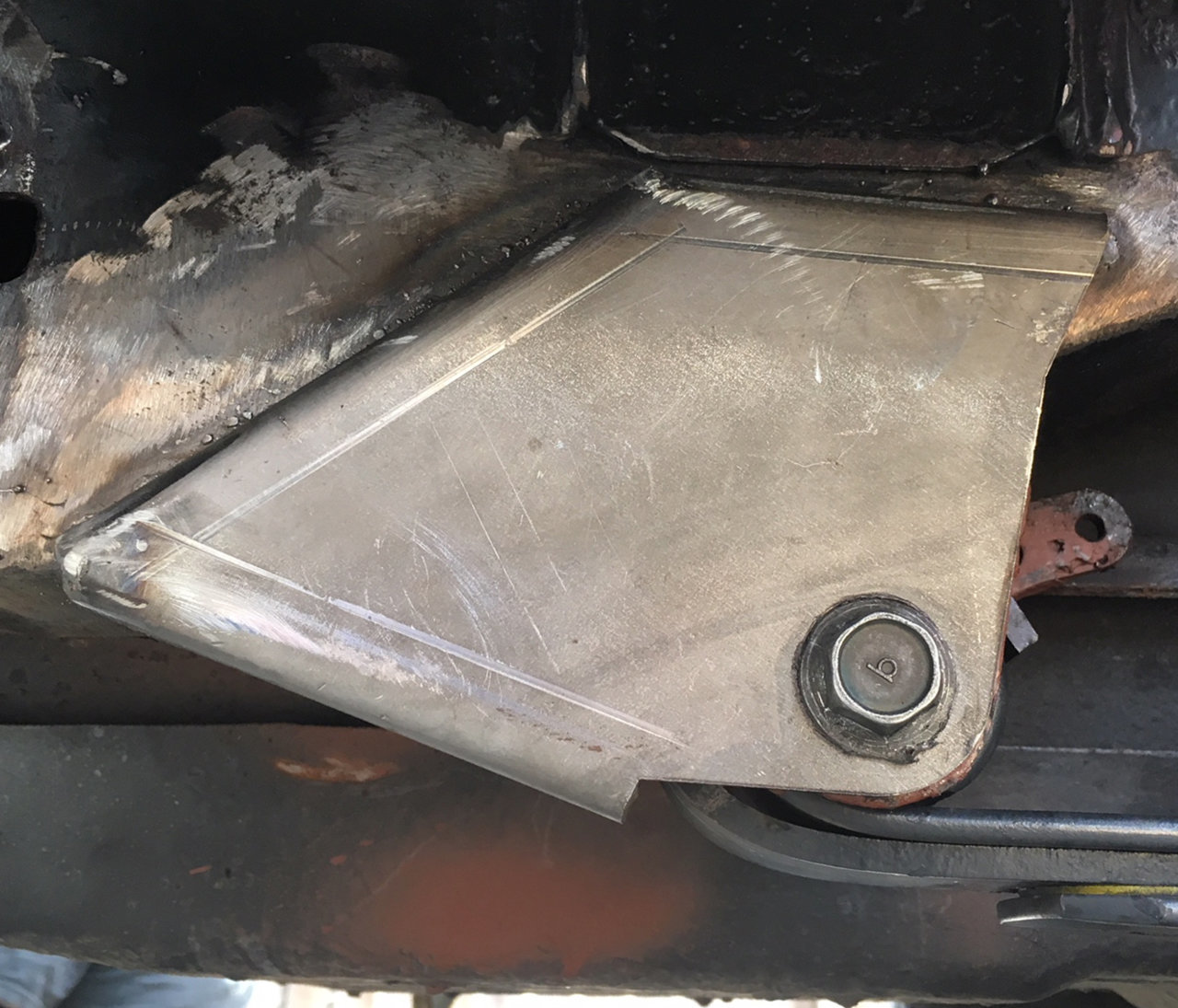

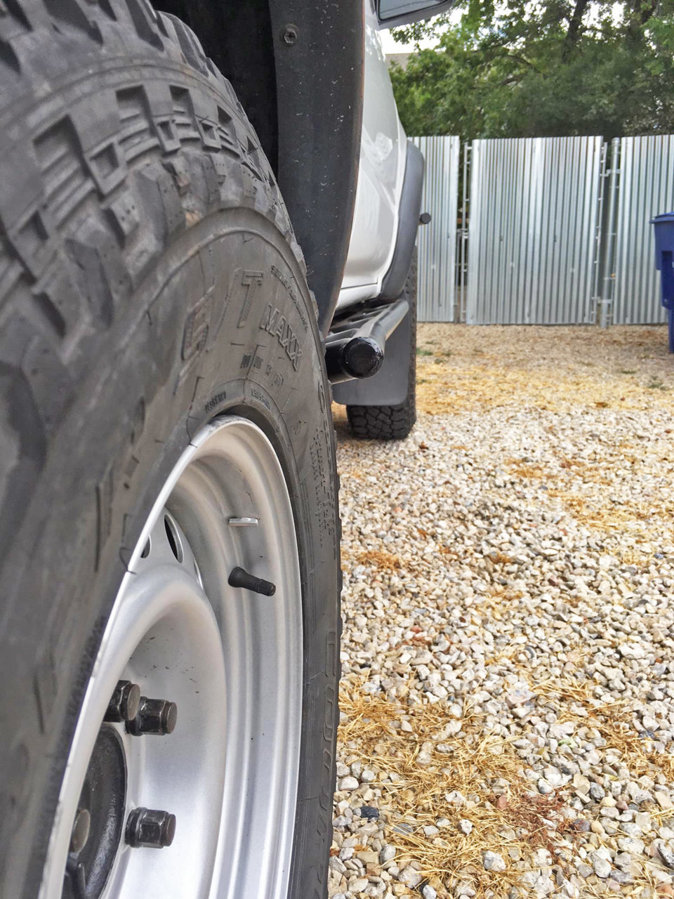

    Thanks to @Jiveydude, Sky's Off Road Design spring hanger reinforcements and Stubbs Welding rock sliders are permanent.
    Much stronger than stock:
    I'm so chuffed with the fitment of these rock sliders:

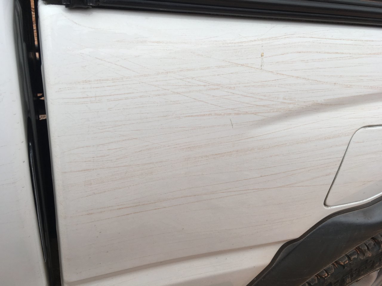

    I went to Boulder Mountain for a family gathering. But I found us a trail that’s really fun if you don’t mind a little pinstriping.

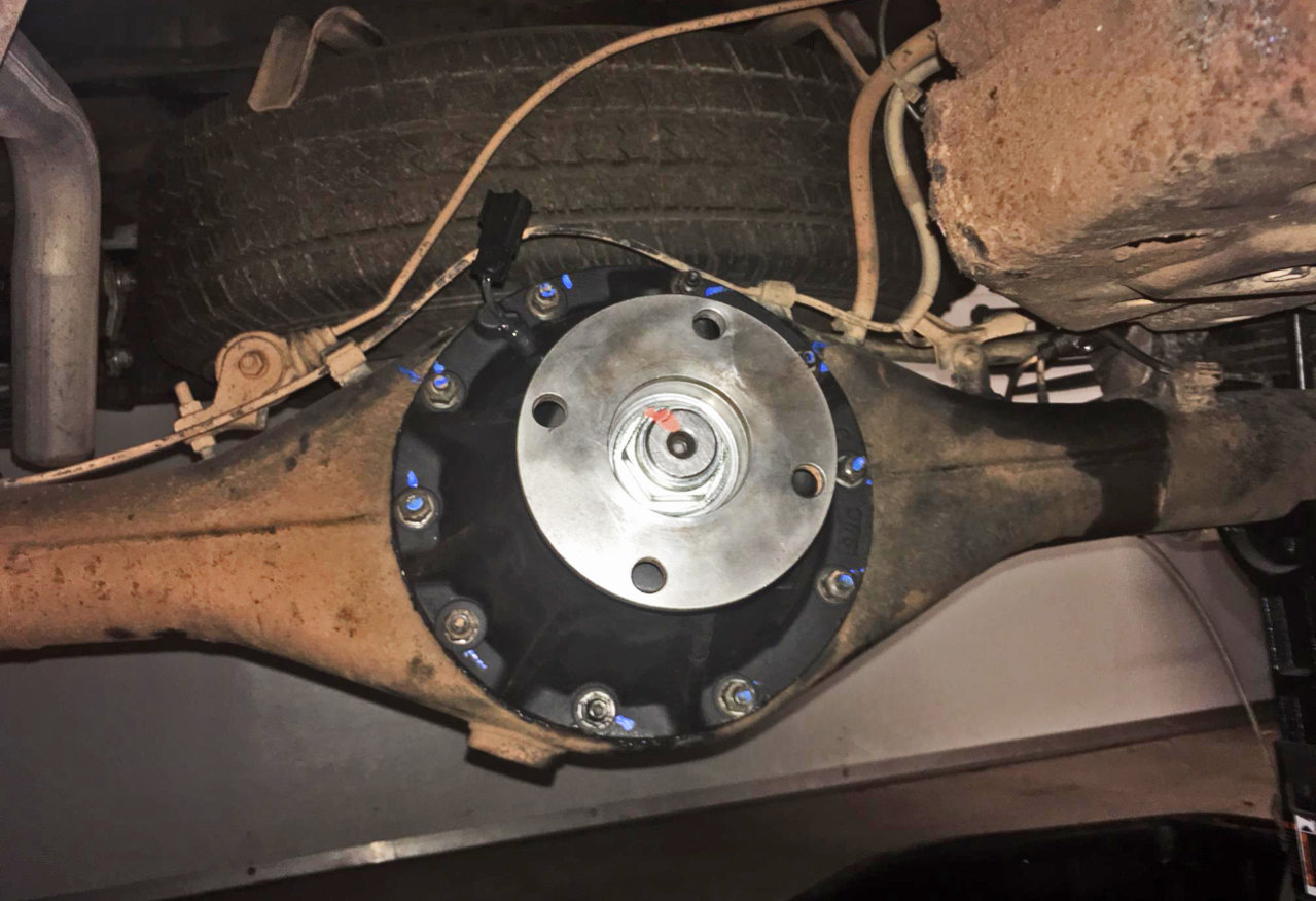

    Diff lock pornography.

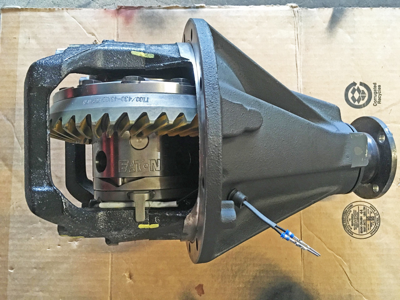

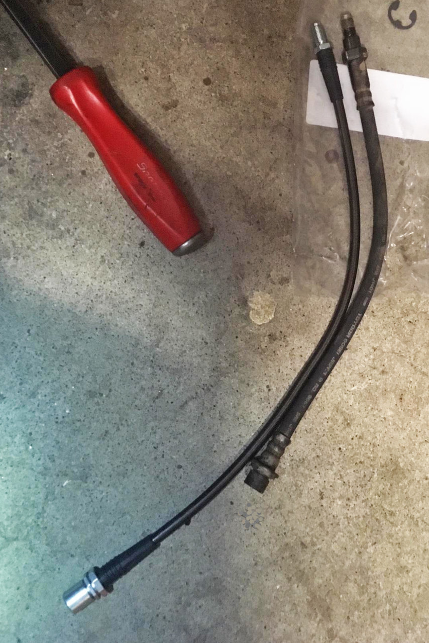

    I had grandiose plans to change the brake shoes and inner axle seals while I had my rear axle apart to install a new Harrop E-locker. But the 15 year old 111,000 mile brake shoes were only a few thousandths thinner than new. The inner axle seals had no visible wear and were just as soft as the new ones I had on hand. Completely pointless to change those parts. This @Wheeler's Off-Road Inc extended brake line is excellent. The female end swivels AND you can put a wrench on it, unlike the stock part, so it's easy to install without getting twisted.
    Harrop E-locker is in! I'll keep the pink, black and chrome color scheme for a while, it reminds me of a 1959 DeSoto.

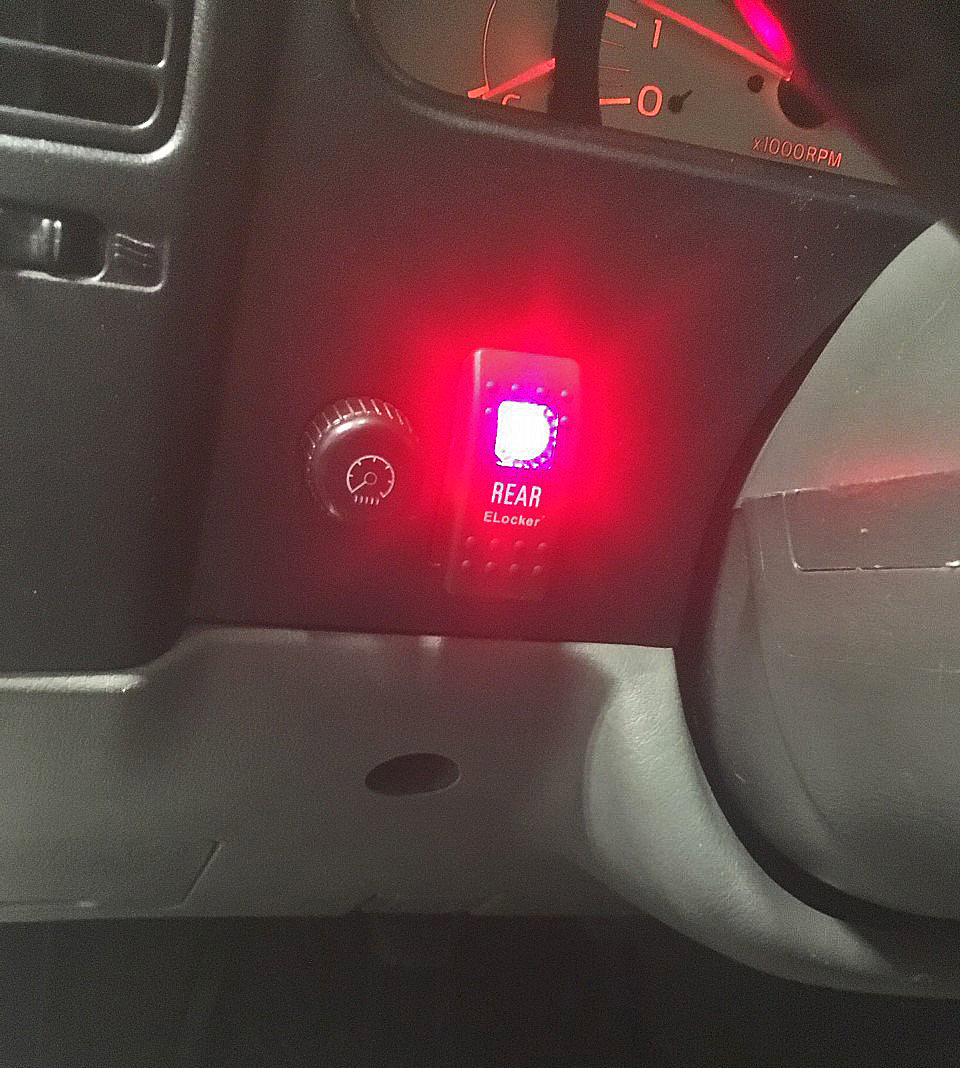

    I finally had a free afternoon to install the wiring and this Harrop e-locker is alive!
    The wiring was quite simple; one wire to unswitched power, one wire to switched power, one wire to ground, an on/off switch and a relay. The locker engagement is silent and instant. I'm really glad I held out for this instead of putting in a TrueTrac or a used Toyota e-locker axle with a zillion miles on it. By the way, the customer service at @ECGS is excellent.
  20. Sep 22, 2018 at 12:29 AM
    #140
    Burro
    Burro Well-Known Member
    Jun 11, 2018
    #256064
    193
    SoCal
    98 v6 4x4 xtracab
    What influenced you to choose the harrop over an arb air locker or the trd axle?
    It does look like a really solid piece of gear!
