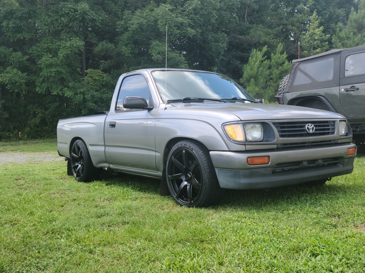

    Quick update. The binding was from it being the 14" wheels. Clearance was minimal and was actually catching the balance weights on the inside of the wheels. The rear was hitting the bump stops, we cut them in half for now and I'll be buying some low pro stops for now. Will be notching the frame in the near future as soon as I get a reputable guy in the area to do it. We did have to trim the rear, trim and roll the front. All is good for now. I'll drop a pic tomorrow!

    Looks good! What are the specs on the wheels and tires?

    Wheels are 18x8.5 +20 tires are a 225/40. Had to roll on front and remove splash guards. Rear we had to trim a little. I have no rubbing at all so far.
