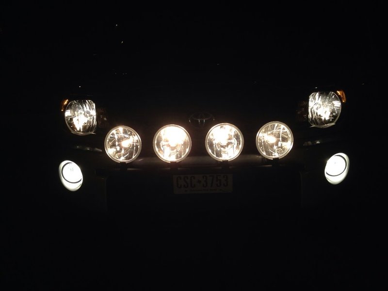

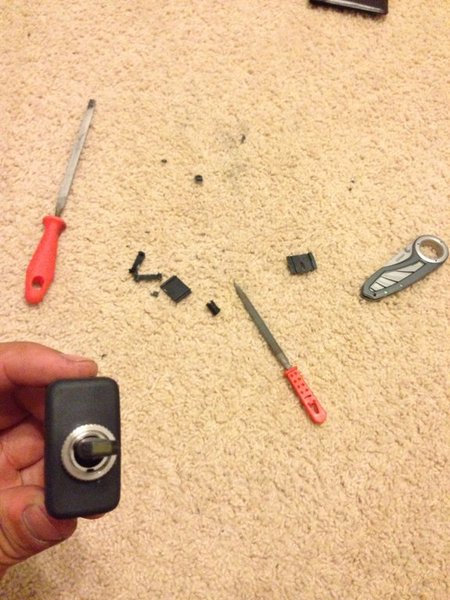

    image.jpg Homemade toggle switch for the hella lights using toggle # 84896 from oreilly auto parts and one of the blanks under the locker/ foglights etc

    Finished up the switches! Fits like a glove. Moved the little alarm button to the most inner slot as well

    Hey. Nice rig. How did you wire up your lights?

    Thanks! the lights are spliced together for the ground and are grounded to one of the bolts for the locking mechanism for the hood. Power for the lights are directly from batt. Relay is grounded to the battery ground. Tied a knot to a nail for the load wire and poked a hole throigh the rubber gasket on the firewall. Got the power for the switch through splicing to my led interior lights (tail light fuse). Hopefully that makes sence because im all woozy from wisdom tooth prescriptions haha

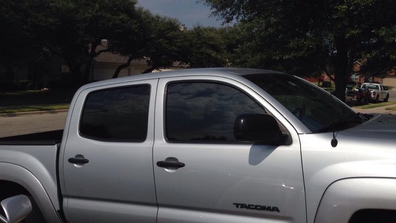

    image.jpg Got my front windows tinted with suntek carbon 35%. Had the manufacturer tint removed. Seems a tad bit lighter than the stock rears but then again theres less light in the back.. It is darker from the inside though

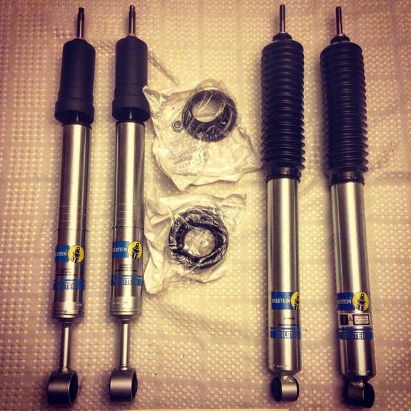

    image.jpg 5100s came in! Eibachs should be coming in around wednesday...

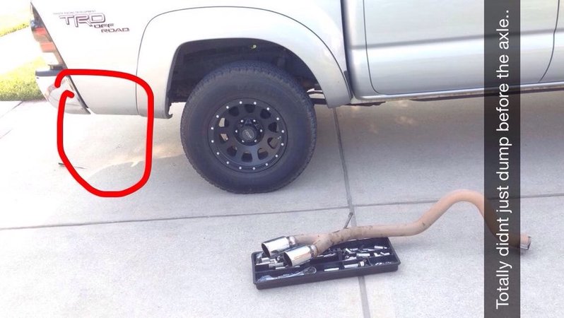

    image.jpg Dumped the exhaust right before the axle. Going to grab a turndown in the morning if autozone has cheap ones in stock

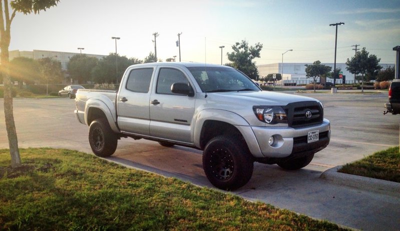

    image.jpg Lift installed yesterday. 5100s with Eibachs set at .85 and a Toytec AAL

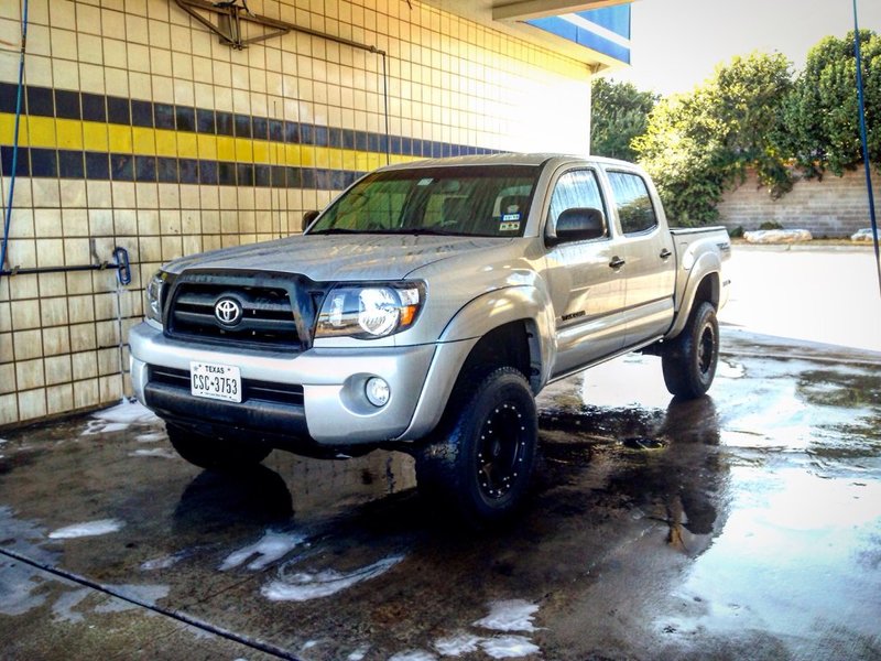

    image.jpg Washed and waxed inside and out

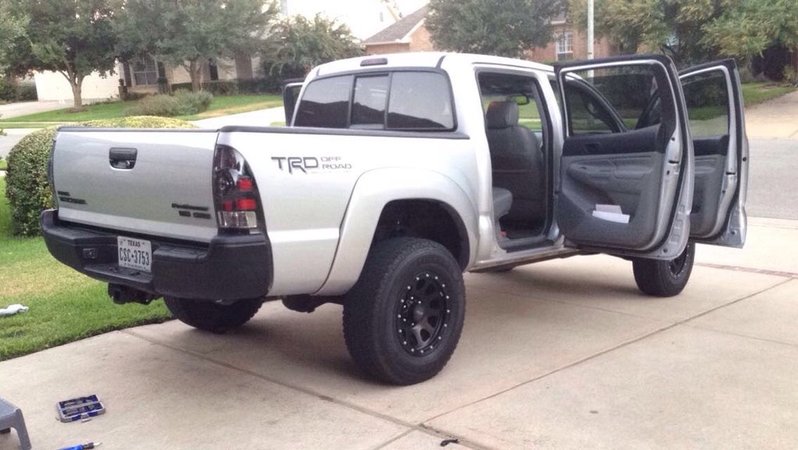

    image.jpg Derped the bumper. No more chrome!!!
