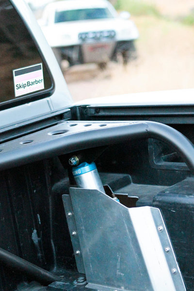

    love the rear shock covers! ( would paint black to match bed) I always hated the holes going through the bed but like how you covered them and the shocks are way up front to give you your bed still.

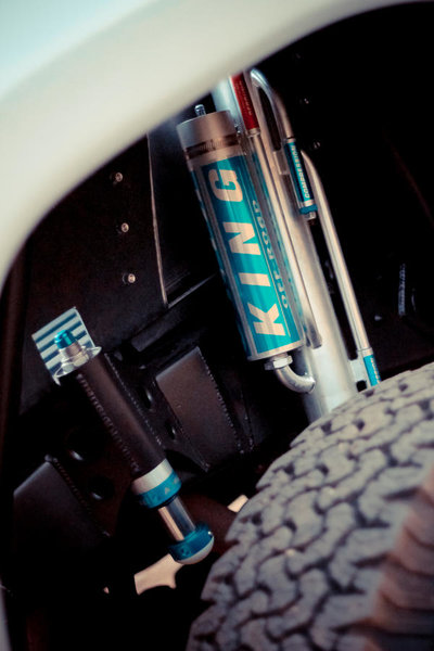

    I don't know much about LT, but I have never seen that 2nd shock behind the coilover. What is the purpose of that? Looks like the best setup I've seen!

    Its a bypass shock. Its used to be able to adjust the front more. It has tubes that you can make the shock softer and harder so that you can get the ride the way you need it for what you are doing. Also you can make it so on hard hits you will not bottom out and it will be a nice plush landing. Another thing is because you have two shocks it will take longer for them to heat up and fade (In his case it won't happen)

    2 ten inch kicker cvt subs, pioneer deck and alpine 1000 watt class D amp, and flowmaster exhaust, 4 inch camburg lift spindles and my coilover is adjusted to 1" (5inch total) in front and 3" All Pro leafs, KING off road racing reservoir shocks and coil-overs, KR FAB CUSTOM BUMPER with three 9" HELLA 4000 Race LIGHTS , HID headlights with rigid amber LEDs , "KR Fabrication" custom built bumper, sliders and tiregate, Full size spare with matching rim, custom bed bar with two amber off road lights, cb radio, also BHLM (thanks Ray), and debagged
    secondary triple bypass... PURE BAD ASS is what u call it haha... its an adjustable shock that can be adjusted to damn near any terrain u want... also make the front end feel like it landed on a pillow haha...

    the more intelligent way of saying it haha

    Wow man. I didn't even know there were setups out there that actually involved having shocks go up through the bed. Thats the most awesome thing I think I've ever seen done to a Tacoma.
