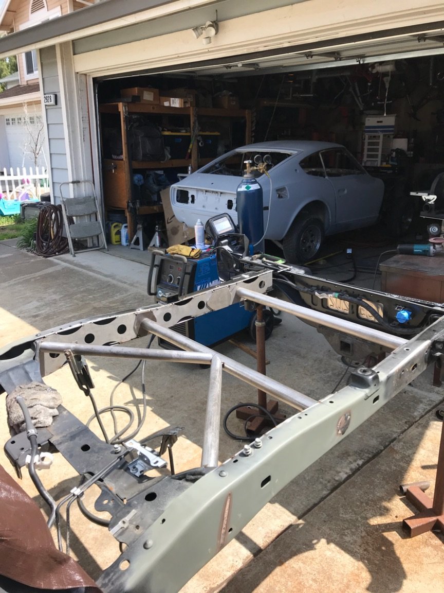

    In the process of doing mine still got a quite bit to do time and money is always a factor lol

    That 240z tho.

    i think its a 280z actually but same difference my buddy is building a cage for it

    Looks good so far. What diameter/wall thickness tube did you use for the crossmembers?

    1.75x.120wall going across and 1.5x.120 wall for the diagonal
