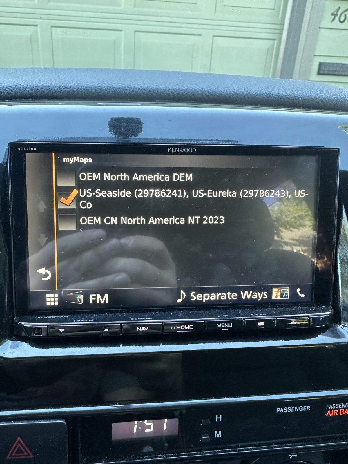

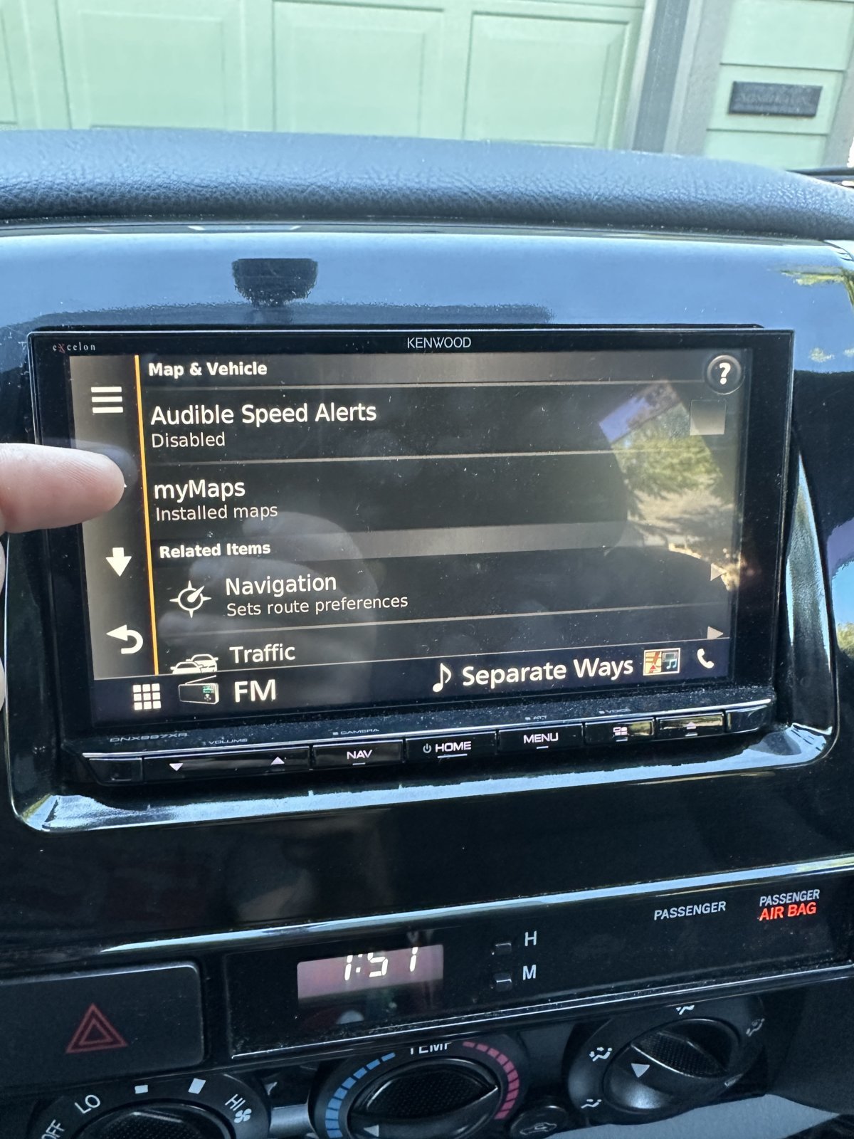

    Here’s the screen where I can pick which map is being shown. OEM is the map set that came with the unit from Garmin, the US maps are the West Coast OSM maps I installed. I’d venture to guess City Navigator would show up here, assuming you have enough space on your SD card
    You can also upload saved tracks, etc although I haven’t done that in a while. I use my handheld 66i for saved routes.

    Thanks for the info! It sounds like you're running the addl maps off the SD card all the time ??? or do they copy onto the system? When I loaded city nav it was like a map upgrade, the card was only needed for the initial install. I've never seen that map selection screen on my Kenwood. Was it always there on your system or only after you inserted a SD with other maps on it? Sorry for all the questions and I'm going to dig into that link. I use nav off road all the time, being able to load up my routes and tracks on the kenwood screen outside of gaia would be ideal.

    I believe the 3rd party maps run off the card whereas the OEM Garmin maps are on the head unit itself. Linking an SD card to your unit should allow you to upload maps, update any Garmin maps, etc. Try poking around in your Garmin nav menu to see if you have the same options. I believe you should have something similar that will allow you to switch between maps on the head unit.
