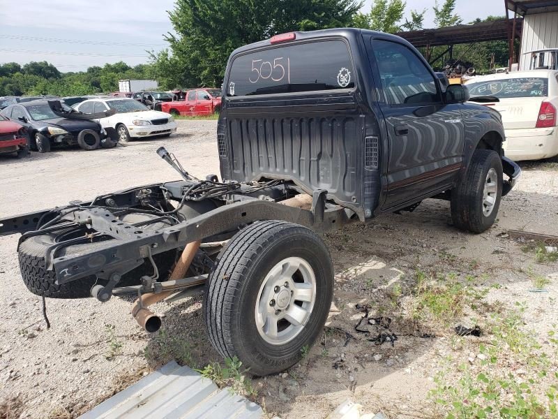

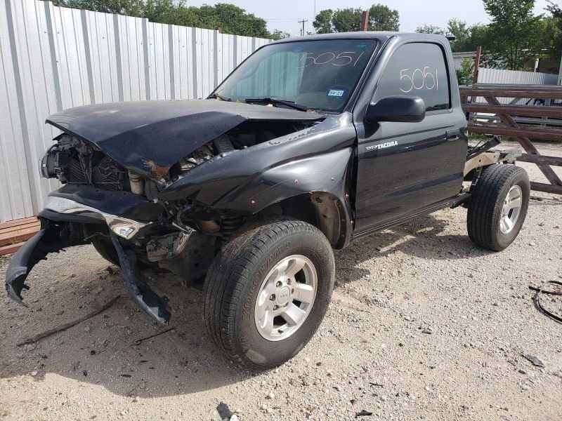

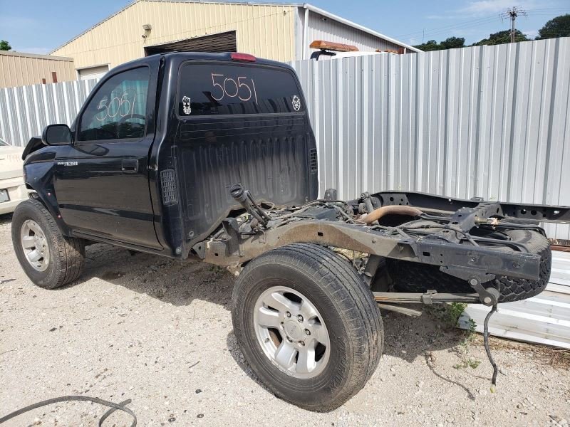

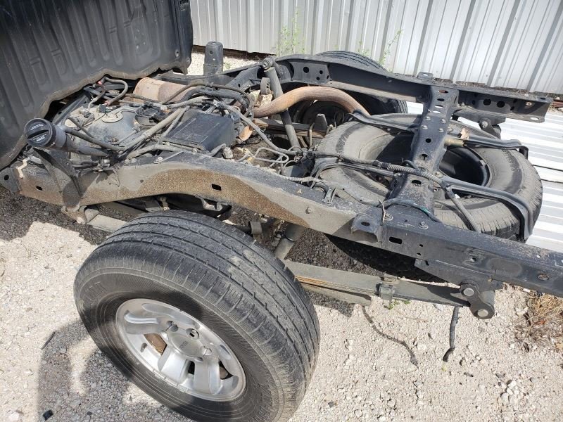

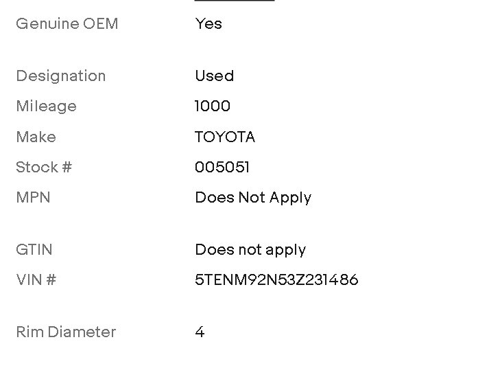

    OK so I'm going to post some pictures why I thought it was/is 6 lug, and I hope it is!
    He shows the stock # as 005051 and that same # 5051 is stenciled on the windows of the picture of the truck showing 6 axle lugs. This would be misrepresentation I think if it turned out to be a 5 lug.THIS 1.jpg THIS2.jpg THIS3.jpg THIS4.jpg THIS5.png THIS 6.jpg

    02hilux
    02hilux What do you mean there’s no road, I’m here
    Sep 14, 2016
    #197244
    6,321
    Planet: EARTH
    Definitely a 6-lug. Gear ratio B07A identified as an 8" third with 4.30 gear ratio and 2 pinion open member. Though i wouldn't fully agree that sticker may actually match gear ratio in the punkin. Make sure your truck have the same gear ratio before running it because you're 4wd and don't want to blow your clamshell or visa versa

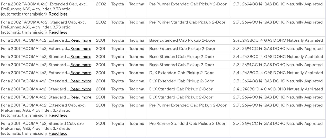

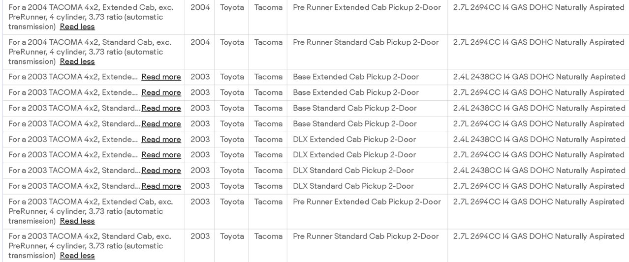

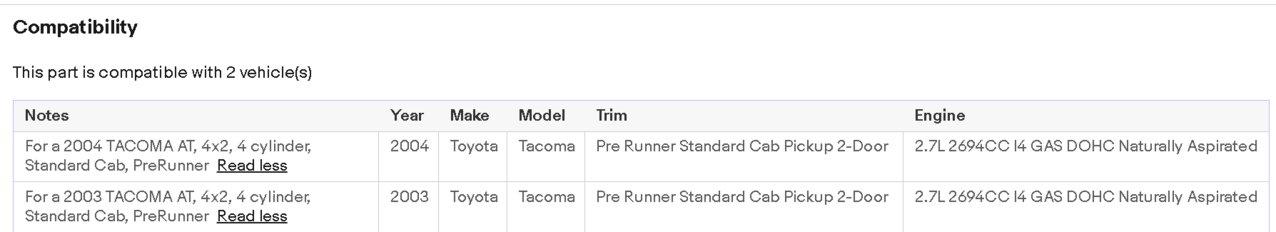

    In the application charts they show for 2WD ext. Prerunner . Then they also show Prerunner in the second column. I just hope they have all this crap straightened out and send me what I need.THIS 7.png THIS 8.png

    So I searched out all his other parts and came to the conclusion that the donor vehicle was a 2003 Prerunner. It would have been nice for him to just say that. I still don't have the part in hand though.

    And thanks to you I know a Prerunner will have 6 lugs! Thanks again...I can sleep now knowing I won't have to go through a return process plus locate a new axle!
