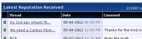

    Really?
    I provide helpful information and some sackless douchbag neg reps me without signing.
    No good deed goes unpunished I guess.
