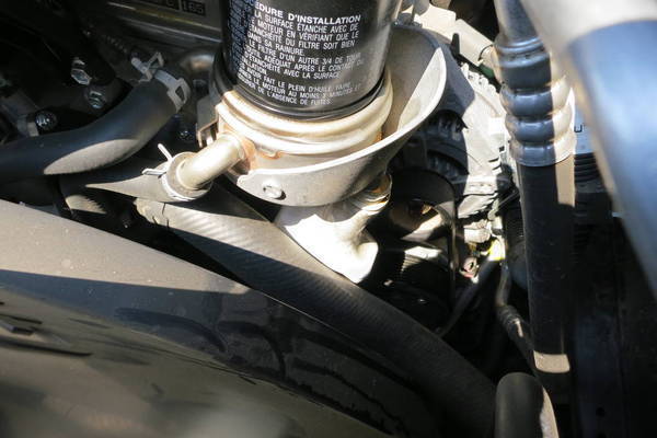

    I had the oil changed on my '13 Tacoma at the dealership where I bought it. I should have done a visual inspection before I left, because this is what I found a day later:
    I generally trust the mechanics at dealerships because I know they go through a lot of training, but this was a surprise. I drove around for about a day an a half and noticed a weird noise that sort of matched the engine RPM but not always. The bottle was wedged against a belt pulley and nearly melted through and dumped about 6 oz. of oil on the belt.

    I'd make them give you a new belt if it were me. I'd also clean up the pulleys really well before putting it on.

    that was most likely put there as a catch for the oil that spills when putting the filter on, bright side is they didn't put a dry filter on, too bad they forgot to take the catch bottle out. doh!

    Wut? It's for catching the oil that spills out of the old filter, not the new filter.

    Sometimes the gasket from the old filter sticks to the engine when removing the old filter. When the new filter is installed it's not unusual for one of the gaskets to split. 40+ years ago I worked in a gas station for awhile as a mechanic. Standard procedure was to take a clean rag and wipe off the area where the filter makes, this practice insures that a gasket which happens to come off the old oil filter isn't left on the engine.
