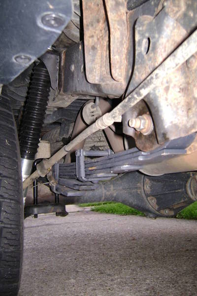

    Yes I added an AAL about a year ago. After 9 months I was at about the same height I was before the installation.
    Then they ended up looking like this, more pics in my gallery.

    MAXTacoma, is that the 1.5" AAL from Toytec on non TSB springs?

    No it was the 2" non TSB from Toytec.

    OK thanks. Reason I ask is I have a set of the 1.5" ready to install on non-TSB, and I was afraid my springs would end up looking like yours do after a while. Kind of W-bent. We'll see here in a bit.

    I think it just depends on what you do with your truck. I tow/haul a lot so I'm sure that had something to do with it. If you dont then I'm sure you'll be fine.

    That load of wood was one of many. I think what really did it was when I towed the boat about 4 hours south. I had the whole bed of the truck filled with gear/coolers. Honestly is you tow/haul a lot I would look into getting either a new leaf pack, air bags, or the timbrens. It sounds like your current leaf pack is shot (mine was) and the AAL can only make up for the weak leaf pack for so long before it also becomes weak. It would have been nice for me to know this before I wasted my $$$/time on the AAL and just went ahead and bought a new leaf pack in the first place.
