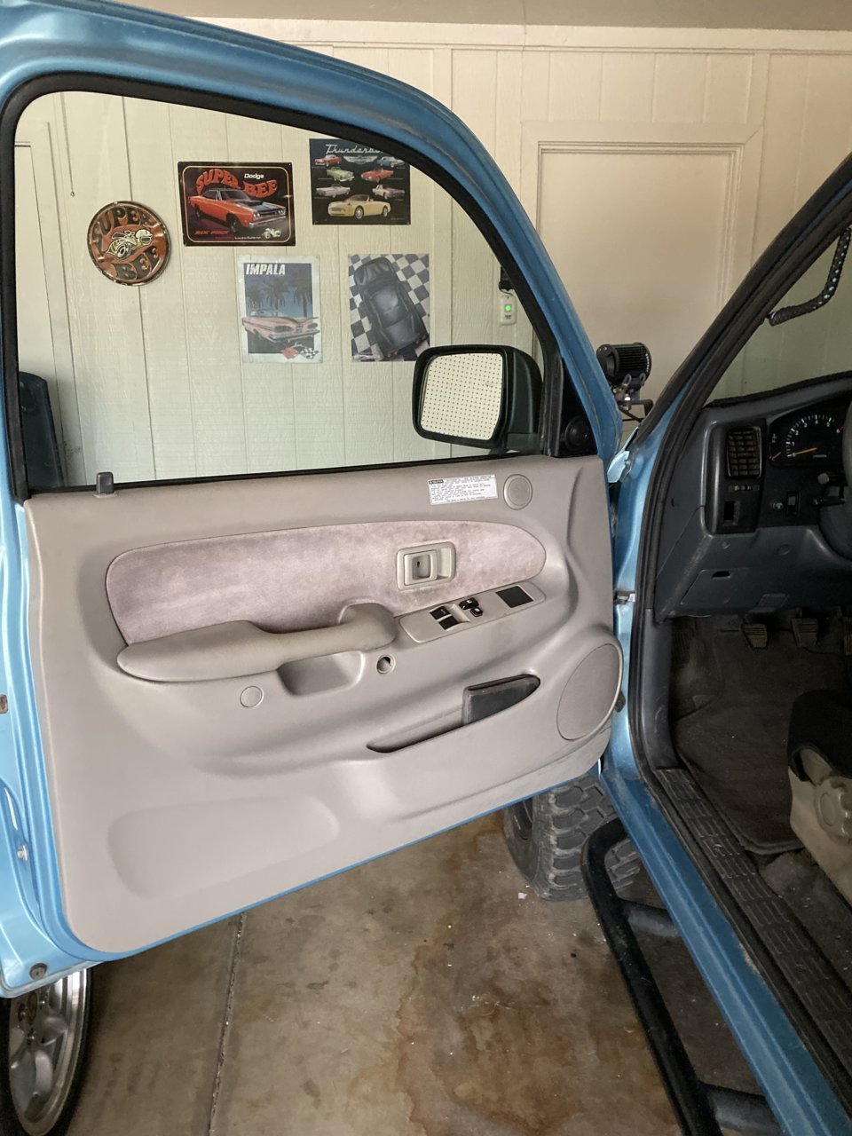

    Over the weekend, I added 2001-2004 door panels to my 1995. Does it fit? Perfectly! Is it plug and play? Nope! Passenger side plugs in fine, but the drivers side requires the wiring harness from the newer 01-04 trucks. Also, you’ll need to move your lock wire pin to a different location. Also, you’ll want to dig your original speaker wiring out of your original door harness and tie it in to the new harness for simplicity.

    Going to pull the trigger, and try this mod. In your photo, looks like you have no power mirrors/ control? My taco has them SR-5 95 1/2. Looking to figure out the wiring, connections for the drivers side. did you do any notes on color code matching with the old/new?. Was there any issues with the door clips. I see the 01-04 has a slight diff in configuration door clips. I have the same color, interior, how do you like the new light color of Toyota Gray> Thanks

    You’ll want all the wiring from the 01-04 truck on the drivers side only. Pass side should plug in assuming you had power doors to begin with. The differences are audio (swap that over from the original harness) and the door light (that power splices in to the door unlock I believe.)
