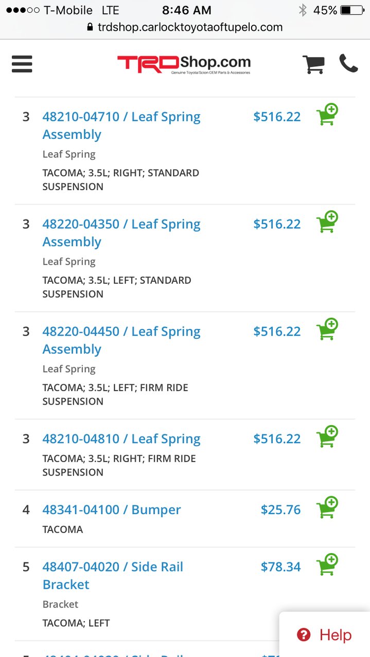

    Some people though I was joking but check this out. Standard and firm ride suspension available according to TRDShop.

    Also a different PN number on the pro 2017 Tacoma TRD Pro Rear Leaf Spring Pack Part #'s

    Apparently the SR 4wd Access Cab uses Standard 48210-04710 only. The SR 2wd Access Cab has the option of Firm 48210-35810 or Standard 48220-04350.
