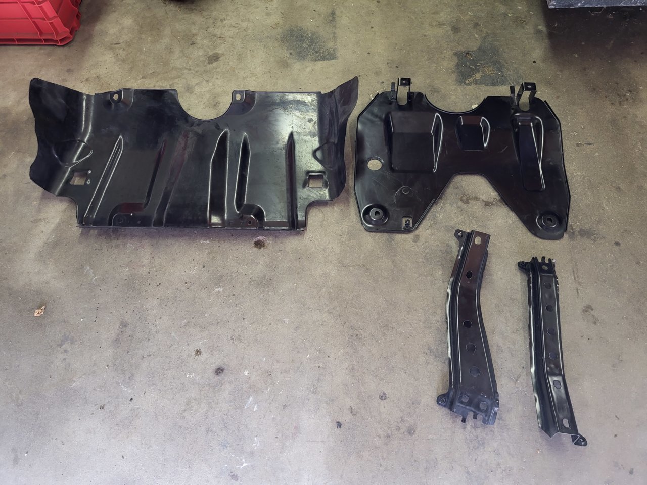

    i cant seem to find it on my 2023 SR5. the one on the top right. would i benefit from one in the winter from the salt/snow on the roads?

    No, I think only the TRD Offroads have them and probably the Pros. My TRD Sport didn't come with one.

    OP What you have pictured, and the part number you provided are two different pieces.

    I'm not sure what comes on the OR can be classified as a skid plate. It's more of a beefy splash guard.

    I didn't even know I didn't have the smaller one until I saw someone else selling their take offs. Went and looked and sure enough (2020 SR5) only the front guard. I was able to pick up a used trd plate for 150 bucks and that took care of it all. the whole trim level skimping on the skid/splash guards just seems stupid. SR5 also does not have the studded fuel take straps or skid.

    Just get a real aftermarket skid

    TRD Pro skid, RCI (steel or aluminum). Both cover back to the oil pan, both have holes for oil plug and oil filter.
