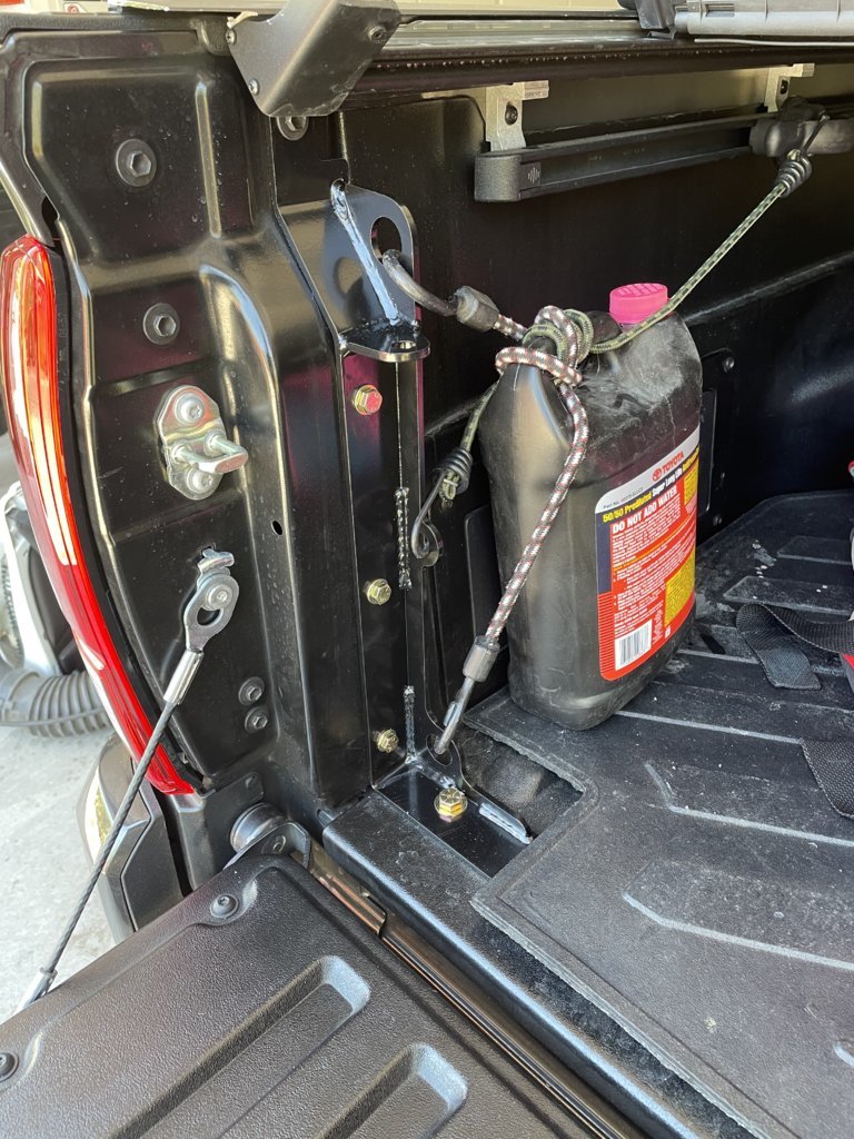

    I installed a Leer cap in my brand new 2015 and had cracking in the exact place(s) Ryan posted above. Bed stiffeners stopped the cracks from spreading and the tailgate gap is much better
    They do the job with no adverse effects

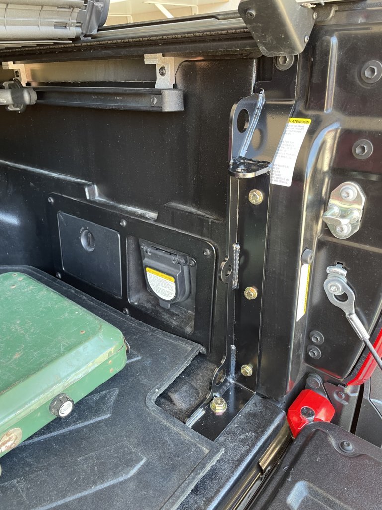

    Even driving on a bumpy but mostly smooth forest-service road the entire truck wiggles some. At the tailgate end the bed-walls have no stibilizing structural member.
    You are not adding any more stress than is occurring already ... you are just putting most of that stress into angled steel braces which you can replace much more cheaply than the truck bed IF those braces fail.

    Nice and beefy, yes. But get spare nuts that back the bolts that end up "inside" the tight-to-work-in braces inside the bed wall. My fists of ham dropped one or two down into the black hole just under the tail-light bay and needed to drive to Ace to get more to finish the other side of the truck.
