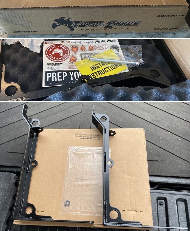

    I have the Total Chaos ones, and they are annoying for carrying 48" wide items. I think they are around 49.5" at the narrowest point between the tie down loops. The relatively thin edge of the metal stiffener tends to damage the edge of whatever I'm carrying, particularly while loading or unloading. Note that some 4' sheet goods are actually 49" wide (MDF in particular).

    (1) A flush-mount option was created by a TW member, if you want to change out TC (2) Get some harder foam that can slide over the thinner edge of the stiffener to try to remove that stress-point.

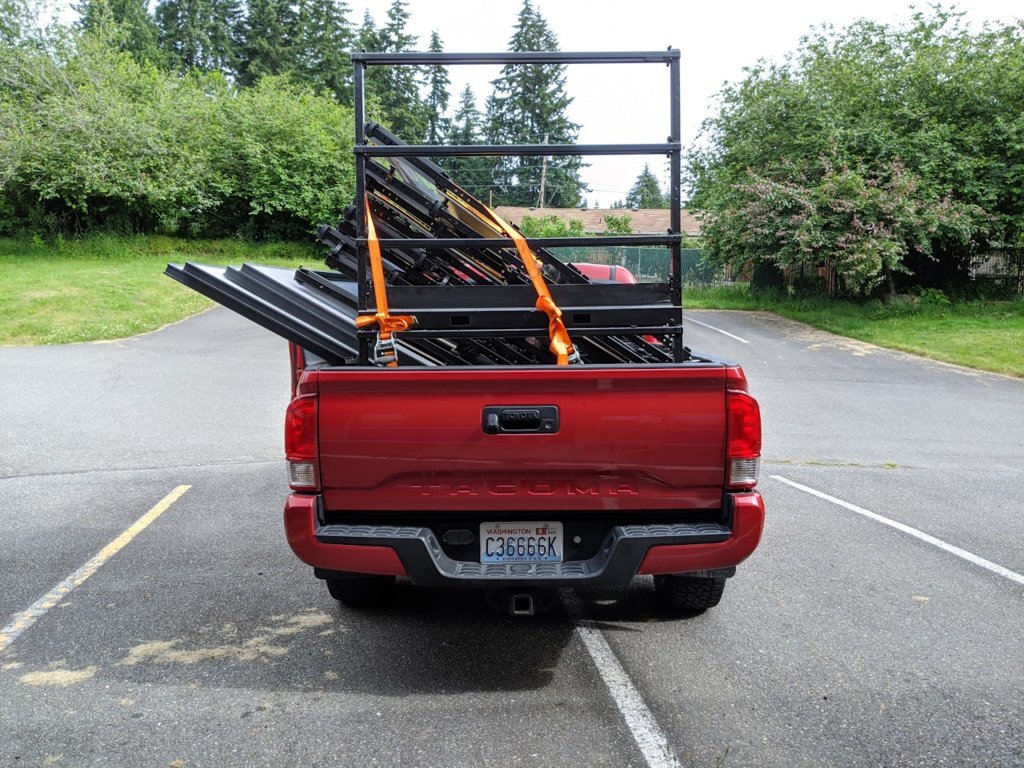

    I've always had a tough time understanding the "need" for bed stiffeners. I can justify the need for a camper shell, because its fiberglass and flexible, and I understand how they'd work exactly as intended. What I can't understand is the "need" for stiffeners if you're running a steel bed rack (with any amount of weight on top) or a diamondback bed cover (this one strangely comes up alot in these threads, I guess it weighs alot). Would a steel bed rack or bed cover not serve as a giant bed stiffener/internal cage? If the goal is alleviating outward spread, how does a steel bed rack thats bolted to both sides of the bed tracks, distributing the mounting surface over nearly the entire bedside on both sides, not serve BETTER as a bed stiffener than actual bed stiffeners? Given the design and bracing of most any steel bed rack, I don't see any of them physically being able to 'spread outwards' from any amount of pressure/forces a truck driving on or offroad could simulate, and both bedsides spanning the entire length of the bed are bolted to it. Maybe if the truck were flipped upside down and fell 15 feet or so on its top. I don't imagine any downward force/weight on top, other than a rollover could cause a bedrack to spread/widen. Same idea for bed cover (assuming it mounts using the bed tracks). Does it not just act as a stiffener, given it doesn't really have any flex? Even though a bed rack sits above the bedrails and can incur additional side forces, is it still not the same idea as an internal cage bolted to both side bedrails that would sit within the bed?

    A rack does not change the load through the corner. Sure, it might be a bit stiffer from mounting point to mounting point, but it is still weight being supported by the bed sides, where the load is high up and still pivoting through the flawed area.
    Weakness spreading open is equal and opposite. We obviously don't put pressure inward and don't see that being a problem, but it is the same area reacting the load.
    Also, not all racks are the same. Some are strong through the corners, some are just a couple bolts.

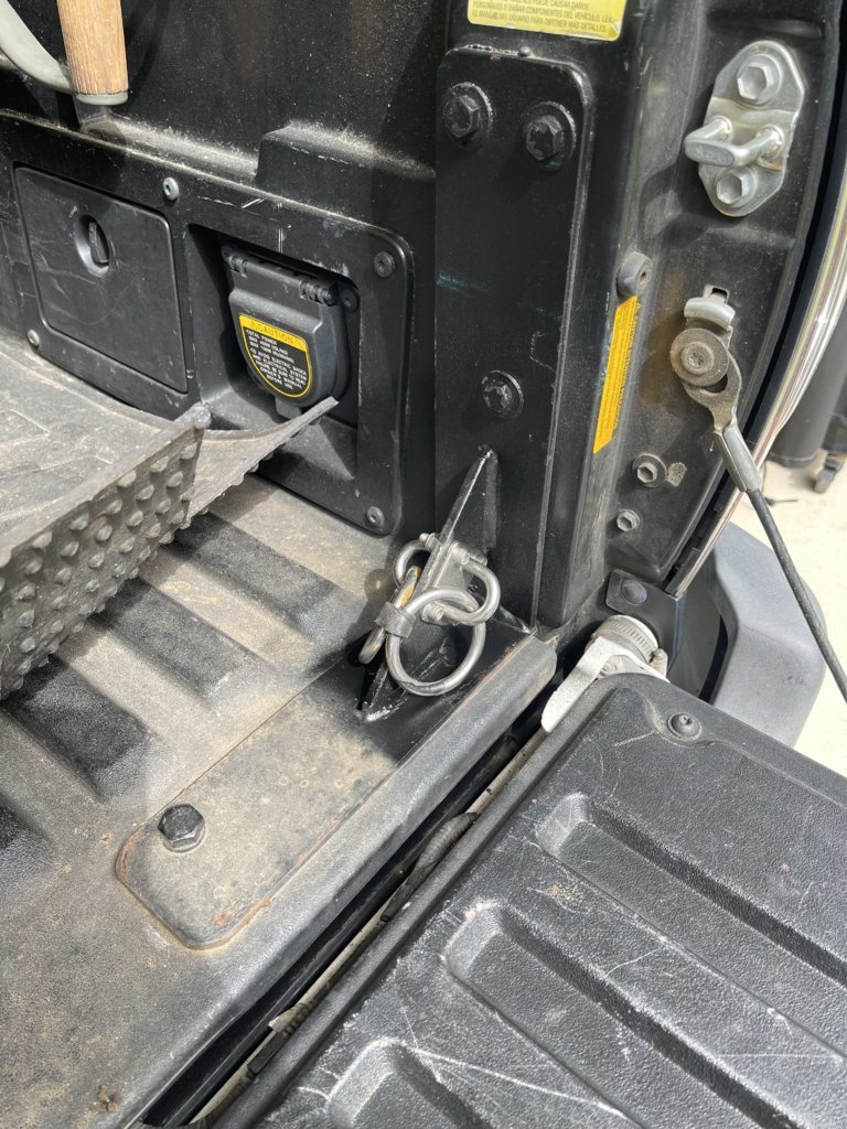

    Been to lazy to go out and take a picture but years ago I built my own bed stiffeners. I used 1/4 x 3 inch bar. They also have plates on the inside. The stainless tie down rings came from Harbor Freight.IMG_6848.jpg
