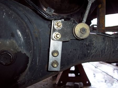

    Don't forget about the BPV valve on the rear axle axle when bleeding the brakes, too. That also gets bled

    Do you have a pic where this is located?

    This is the bpv bracket on the back of the rear axle...if you follow the line up from there you'll see a bleeder valve for it
    Edit - you have a 2nd gen so it may not be the same as 1st gens
    CS_AR and Murphinator[QUOTED] like this.

    mines a first gen, thanks for the picture of the bracket, whoever lifted it never added that. I will deal with that this weekend too

    Yeah the bracket helps return some of the rear braking power back to normal after you lift it

    Will it increase the rear braking cuz I have relatively none now:anonymous: But when it’s under the knife this weekend doing the axle bearings, seals, brakes etc so figured I would add it.
