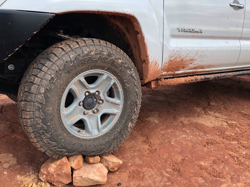

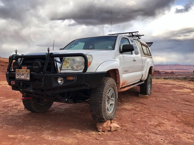

    Spent a couple days over in Utah.
    Not too shabby other than the slope where I parked that night requiring some leveling of the truck.
    This is an E-range Falken Wildpeak 265/75R16 at 28 psi. They are stiffer than maybe passenger tires but it's not like you'd be running wooden wagon wheels.

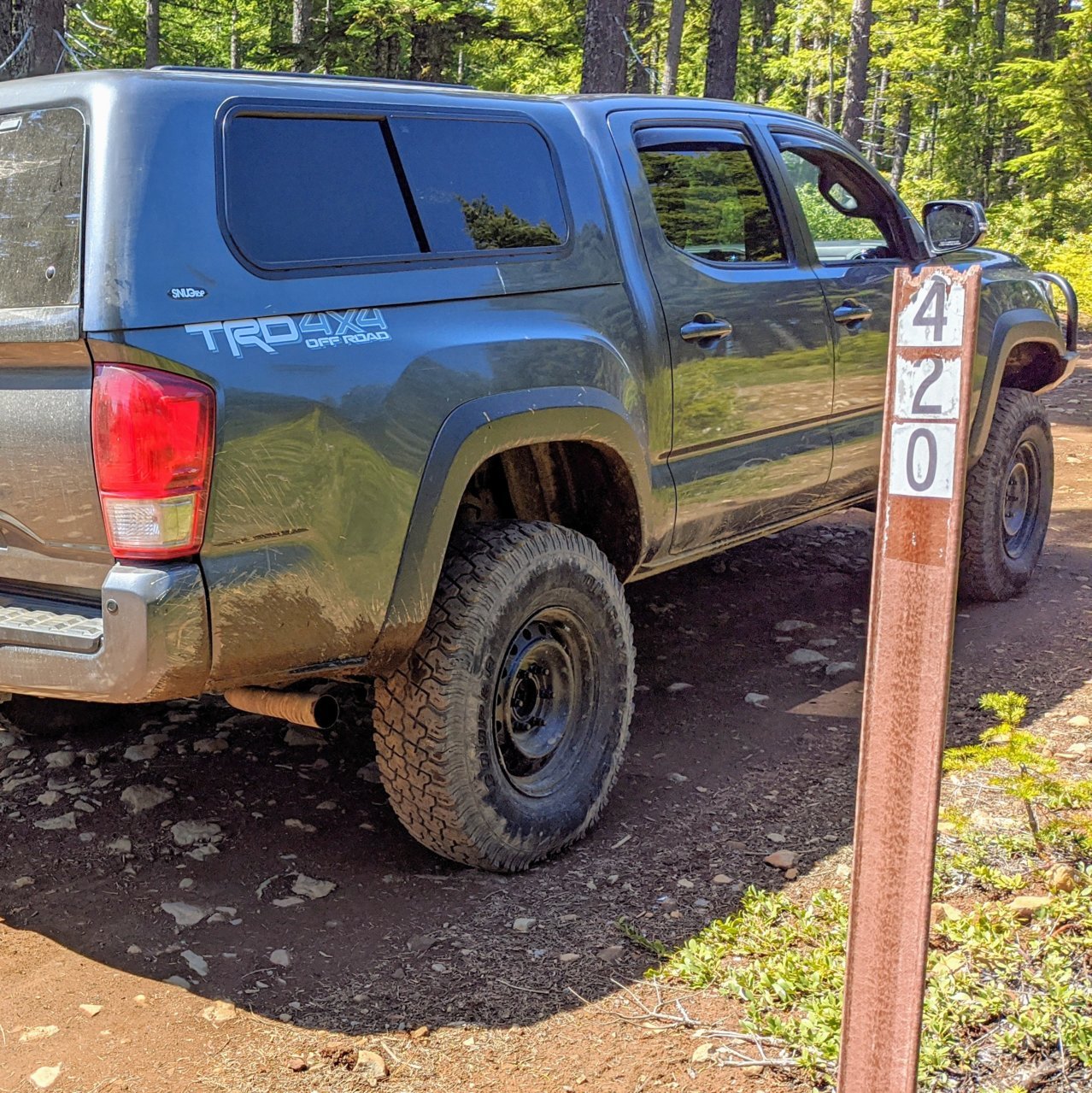

    5.29 gears, OME HD lift, OVTune
    Cooper 255/85/R16 D-rated
    It feels like a truck to me. I noticed a bigger difference when I got OME 886x coils and HD Dakars.
    Tires are at 20psi in the pic
