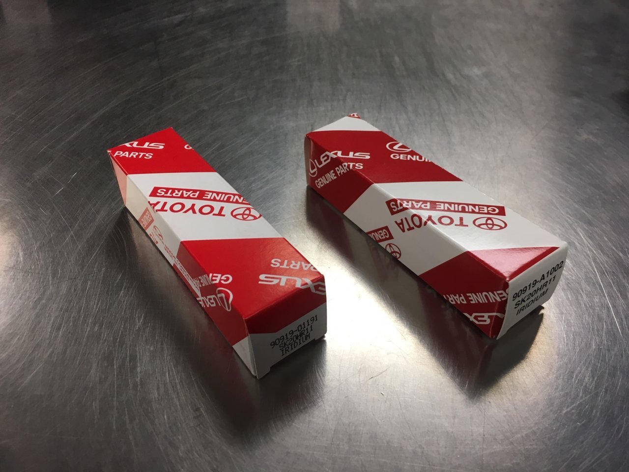

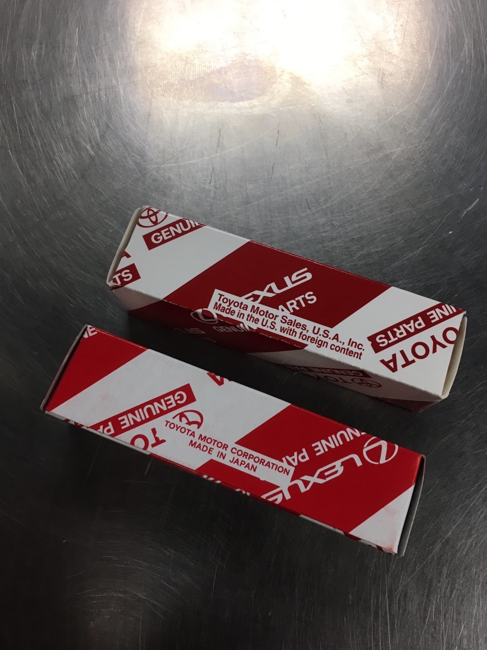

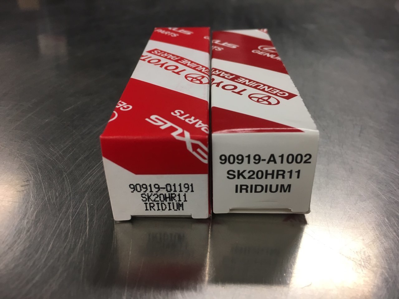

    90919-A1002 is an SK20HR11 supplied by Denso USA to Toyota (Made in USA)
    90919-01191 is an SK20HR11 supplied by Denso Japan to Toyota (Made in Japan)
    90919-A1002 has been in use in Toyota vehicles since 2009. Both part numbers are still available and being used. The only difference is which one the parts distribution network is using in whatever country to happen to be ordering them in. Toyota's North American parts network simply decided to start using the US-made plugs for service supply in Canada/USA.
    To help spot fakes, here is a picture of both current packages:

    great info I never knew the A1002's even existed, my fake ones box looks exactly like the lighter colored red box on the left, ive decided not to use(anti seize) since its the manufactorers rec.
