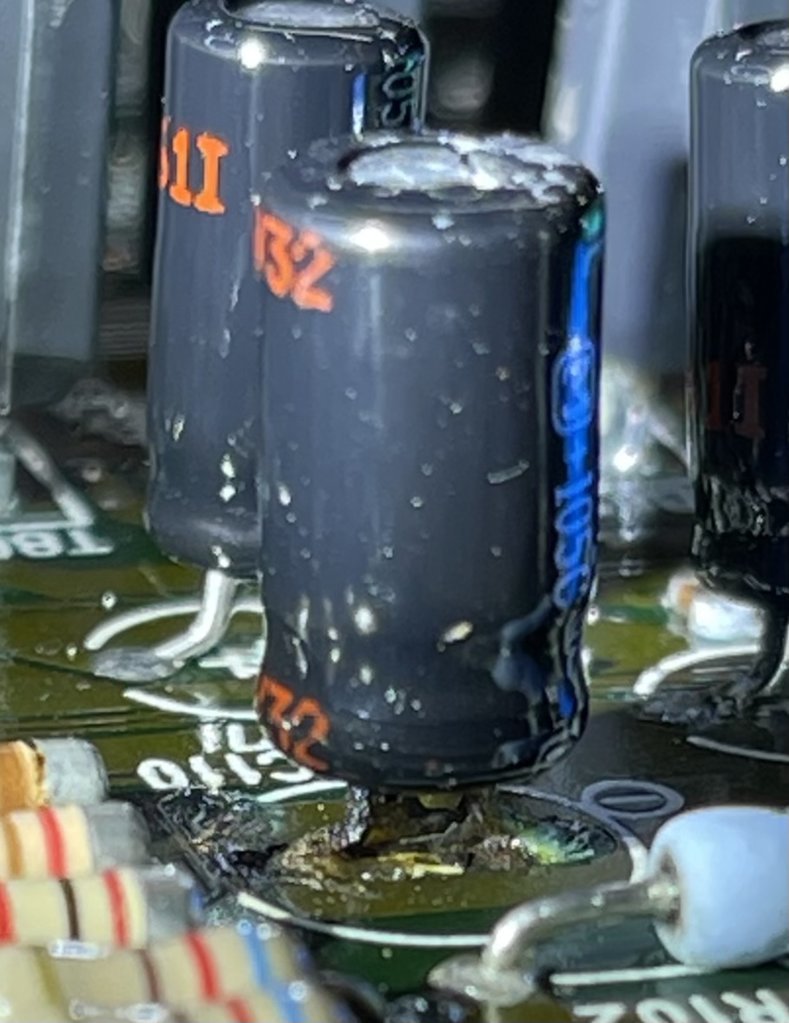

    Anyone had any luck with an ECU repair and return using eBay?

    What is the problem your ECU? Did it blow for some reason, cross connect jumper cables? Don’t know ebay ECU repair, might be BS.

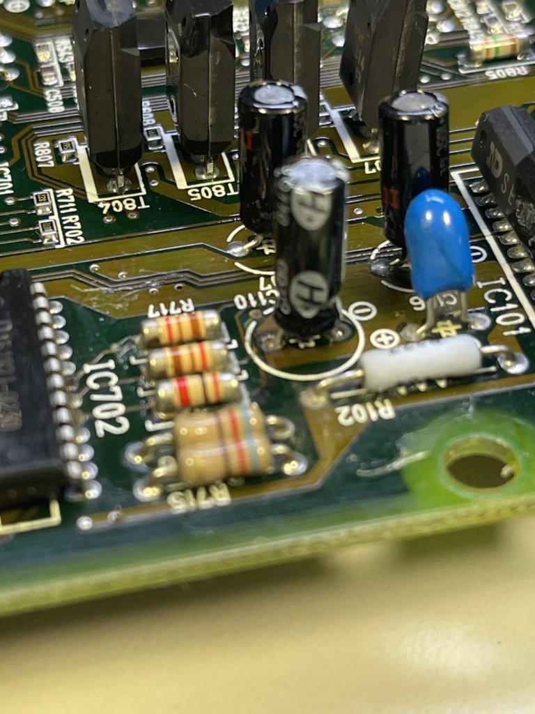

    Capacitor C110 leaked its guts on to the PC board. I replaced it and now the ECU is working again. No need to replace the ECU now.

    care care nut (youtube) had to send an ECU in for that kind of repair but I don't think he mentioned who he sends them to:
    https://www.youtube.com/watch?v=NQLkilkfc-4
    Our trucks are getting to that age this is a thing. But then on newer cars the lead free solder is failing very early and require a reseat job... so theres that...

    It's a long video but a good video. Thanks for the conformation! Interesting how some shops just threw their hands up in the air and said they couldn't fix it. Even the dealerships.
