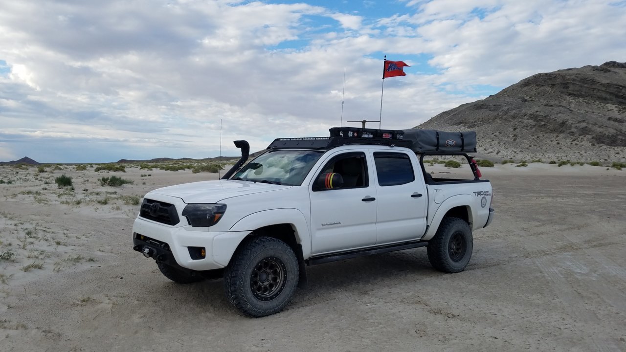

    With all the other stuff as well, I think 650s would be a safe option.
    Granted I'm a 2nd gen, but I run 650s with the below setup + fridge and recovery gear in the bed so about equal to a decked. Have about 2.25-2.5 inches of lift
