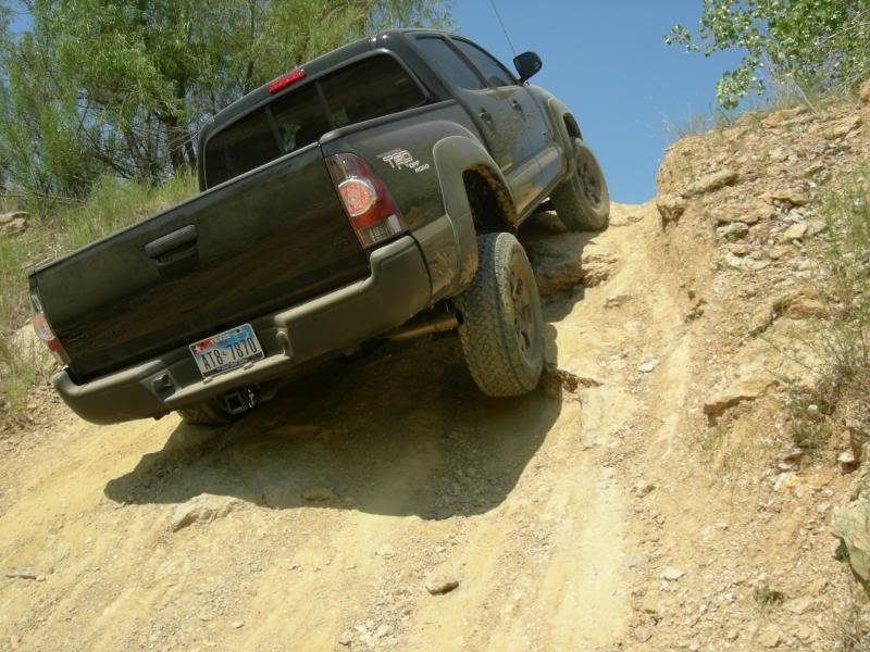

    A locker will help you to climb up and over ledges like this on a steep incline. It also help in any situation where both rear tires need traction.
    A locker was needed here. A non locked taco with beefy tires could not get up this.

    nice pic, and cool story to go with it. I know enough about the locker to know when it should be used, for the most part, i guess what i'm wondering is when not to use it. I think i once read that open front and rear are better in deep snow with momentum, im not sure if that is true. I guess you wouldn't want the locker on in the back on a slick trail with a lot of turns.
    Growing up with ATVs we had no choice, every atv is locked in the back by default. Fsbrains posts seem to suggest that he had mental list of when to use and when not to sure the rear locker.
