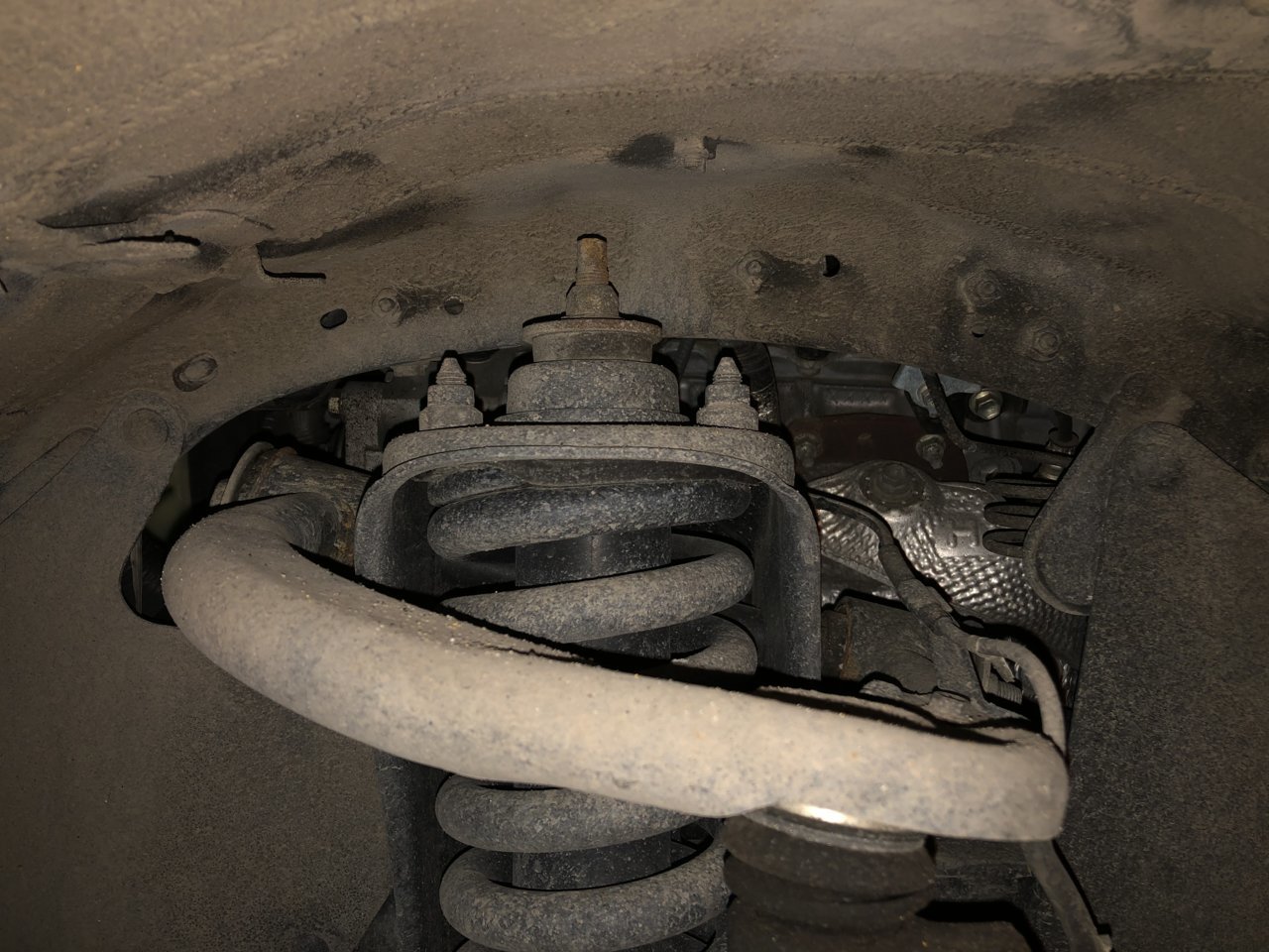

    Kinda random question but my truck is pretty level, the back end (w/ a full tank) is only 1/2” higher than the front. I’m not the first owner and wonder if something has been done here. I’m hoping someone can answer this question I’ve been mulling over. Does it look like there’s a small leveling kit spacer on the top of this strut(front driver side)?

    Doesn’t look like it

    Rear springs maybe sagging a little bit. No uncommon if heavy loads have been carried.

    Those might be icon or king UCAs though...

    it would not appear so based on what you've posted. That looks like a stock UCA and nothing on top of the spring. For better opinion, post pics of the side view of the whole truck, and the rear suspension. if the truck seems level, it may be due to the rear springs. I have a 2nd gen, but the sorry factor springs left me looking pretty flat after carrying a bit of weight.

    Alas
    He does not.

    Welcome to the forum. :hattip:
    It would appear that you do not have a spacer leveling kit installed but that doesn't mean you do not have some sort of lift spring in place. A picture of the full strut assembly would help.

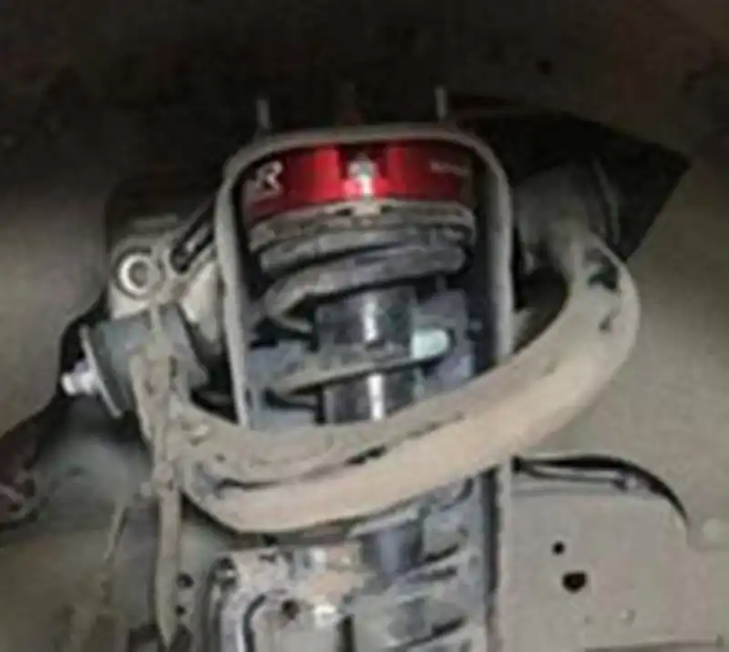

    You might have taller springs, but you don't have a spacer leveling kit (the red thing).

    Do you have the 4 cylinder? Less weight in the front might be causing the truck to sit slightly higher than 3.5 models.
