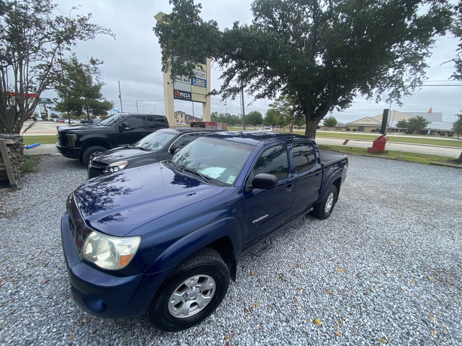

    I have gotten conflicting info.
    I have a 2008 Tacoma with 205,000 miles. I do know, without a doubt, I have the V-6 Engine.
    All I have ever done was change Waterpump, Vent blower motor under the glove box and change the plugs. I just had the truck repainted, due to severe paint failure.
    I am worried about the mileage and whether or not I have a chain or a belt. Either, way, what is the mileage for either that one needs to have it changed. I know you can cause engine damage if the chain or belt fails while running it on the highway.
