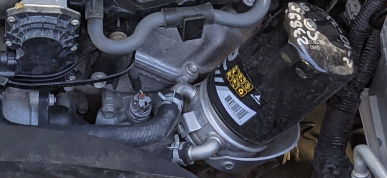

    Open your hood, look at your oil filter, does it have a thick disk under the oil filter with two lines coming out of it? If so that's an oil cooler and only available with the tow package.
    Beyond that the only differences are the high output alternator, not a big deal if you're not pulling a trailer with a ton of lights or extra batteries, the 7 pin plug, honestly 4 pin is fine, the trans cooler if auto, that is a nice thing to have if you're towing near the capacity, long distance, or frequently but not going to stop you from towing, and of course the factory tow hitch.

    I do not have the towing package and the reason it took me so long is that I was under the truck trying to find the oil filter realizing its not under... lol
