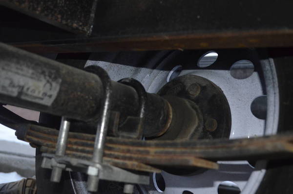

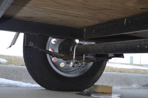

    I'm trying to put brakes on my trailer in preparation for a cross country haul across the Rockies in winter. I'll be towing with my rather light 1st gen Tacoma so I'll need some additional stopping power. I cant tell if there are brake flanges on my trailer though so I was hoping to get an opinion from someone who has dealt with trailer axles in the past. Does my trailer have brake flanges already mounted on it? I was thinking it would be more square shaped but I could be wrong.
    My trailer is a 10x6 Cargo trailer with a 3500lb axle with a GVWR of 2990lbs. Would adding brakes increase the GVWR to 3500lbs?

    No you don't. Adding brakes will no increase the capacity. Changing the axle will. In order to add brakes, you will need an axle with flanges. If you are looking to add brakes, you would be better off just changing the whole axle and get one loaded with brakes.

    Thanks everyone. I'll probably take the trailer to a fabrication shop to have the flanges welded on... that or buy a new axle.

    You are wasting your time getting flages welded on this axle. You can buy the entire axle for less than $250 and do it yourself.
    I buld and sell trailers and I get this ? asked all the time. It is much more cost effective to get a new axle with the brakes already installed.

    new axle for under $250...is that with brakes installed on the axle? I'm thinking I can get the flanges for $14 and welded on for another $60. Then that would leave the price of brakes/hubs/wiring which will be around $225? I'm not sure where I could purchase a new axle locally as I live in a small town right now. Factor in gas or shipping to purchase and it puts me close to the price of a new axle. But I will do some more research around my area to purchase a new axle. Maybe theres a place I'm not aware of that sells them.

    $140 for a set of brakes and drums, I don't know what the backing plates go for, 75 bucks for the welder to put on the flanges, it adds up.
    Get a new axle and sell the old one.
