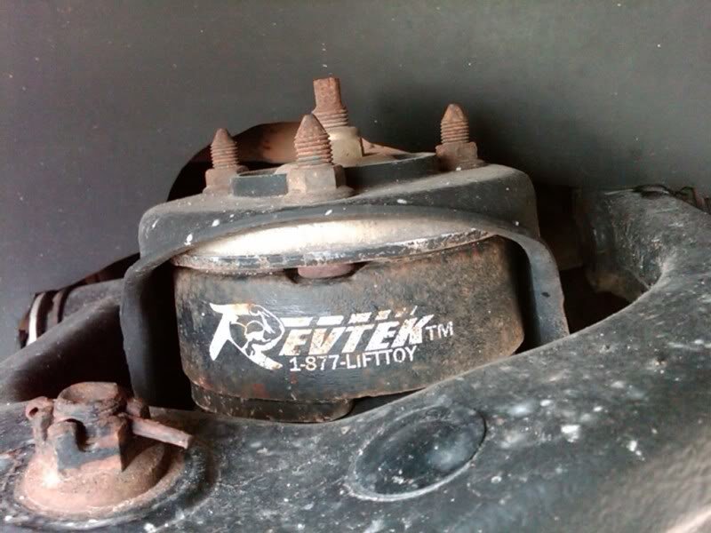

    After much debating about whether I should ditch this Revtec spacer lift/blown shocks for true coilovers or 5100s/Eibachs... I've decided on the 5100/Eibach combo.
    I've heard nothing but good about that setup, and through price savings alone, I'll be able to purchase a nice rear bumper.
    I bought this truck with the Revtec already on it. It was a dealer installed item. Now, the driver side shock has been leaking for quite some time, and the passenger side shock has just started leaking. I'm anxious to get this spacer lift out of there and the 5100s in place.
    However... I've noticed a lot of people talking about how they had to get new top plates for the 5100s, because their spacer lift did away with them?
    I have an appointment at a buddies shop next Saturday, so if I need to get new top plates, I will, but if I don't need to, then I won't.

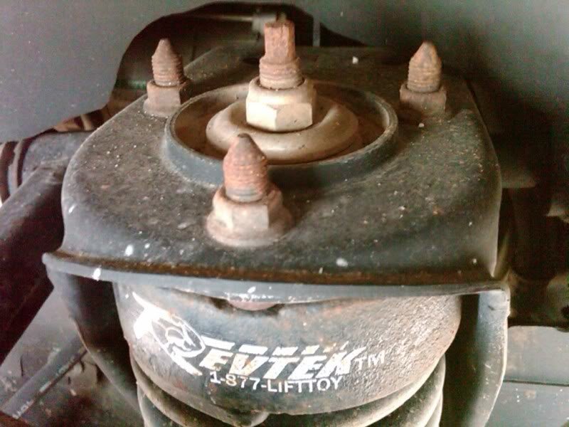

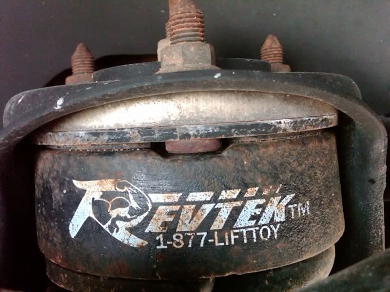

    Can anyone on here take a look at these pics and tell me if I already have the correct top plates, or will I need to purchase them?
    I'm ordering the following from Toytec:
    5100s
    Eibach Springs
    New Upper Bushings (for top plate washers)
    Diff Drop Kit
    Steering Rack Bushings
    Look like I'm good to, or what?

  3. Mar 27, 2011 at 2:14 PM
    t0mills
    t0mills [OP] Well-Known Member
    Feb 20, 2011
    #51524
    74
    TRD, Gray Wire Mod, 3" Suspension lift, 3" Body Lift, 285/75 AT2s
    Ok, I see what you mean now. Looks like I will have to get new top plates though, right? Because I don't have the stock studs and it doesnt look like there is any rubber isolator on these?
  4. Mar 27, 2011 at 2:18 PM
    98tacoma27
    98tacoma27 is going full "SANDWICH" Moderator
    Dec 18, 2008
    #11714
    67,858
    Ben
    Not Beech Creek
    05 Tundra SR5 (+295k AND COUNTING), 2006 F350 King Ranch 6.0L
    Some stuff. Not a lot, just some.
    Yeah, you will want the rubber isolator. You could just get the studs instead of the whole thing.
