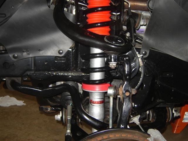

    You don't have to get new (i.e. longer) shocks with a lift, but it's recommended, so you don't lose rear suspension travel when off-roading.
    There's a "how much have you spent in mods" poll set up by tcBob. Last time I checked, median spending is about $2000, with 2-5% having spent $10000+. You have a ways to go. :D
    On a serious note, Rancho has a pre-assembled shock + spring in the QuickLift line that gives 2.5" in the front. It's been on the market a couple of years. The few people here who have tried it, liked it. It's more DIY-friendly than the Bilstein 5100 and OME setups mentioned here.
