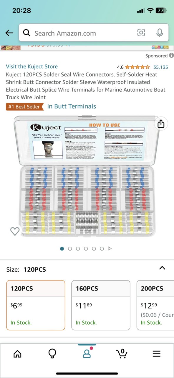

    For interior connections you can use non soldering connections. Plenty of quick connect connectors to use.
    but yes you can twist them and heat shrink. Can also use this
