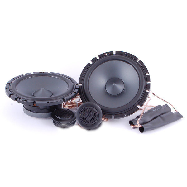

    Looking at the picture of the components looks like there is a small crossover built onto the mid-woofer near the speaker terminals. Every component system I've ever seen comes with passive crossovers. So looks like you're good.

    That's not a crossover - it's a .15 mH inductor coil to keep the woofer from playing higher frequencies (only one component of a passive crossover). You'd want a capacitor for the tweeters as well - maybe included? If not, you'd need to calculate the desired rolloff point (or consult a chart) and install caps also. May need a resistor(s) or L-pad as well as I suspect they'll overpower the woofers if fed the same power. Alpine may provide more info?

    The crossover is pre-wired between the speaker and the tweeter. It fits nicely behind the stock tweeter mount on 2nd. Gens. If you want something easy, stay away from anything that says "component speakers", stick with 2-way or 3-way speakers. They have built-in crossovers.

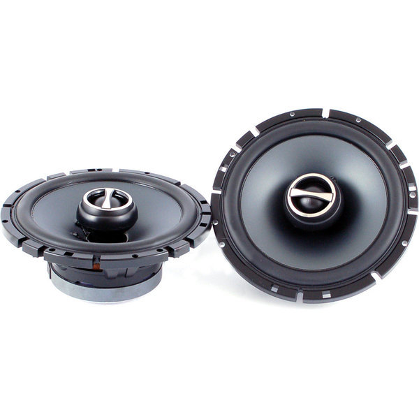

    These are both Alpines. The first photo is 2-ways with the tweeter mounted in the middle of the big speaker. The second is components. The black tubes are the crossovers.
