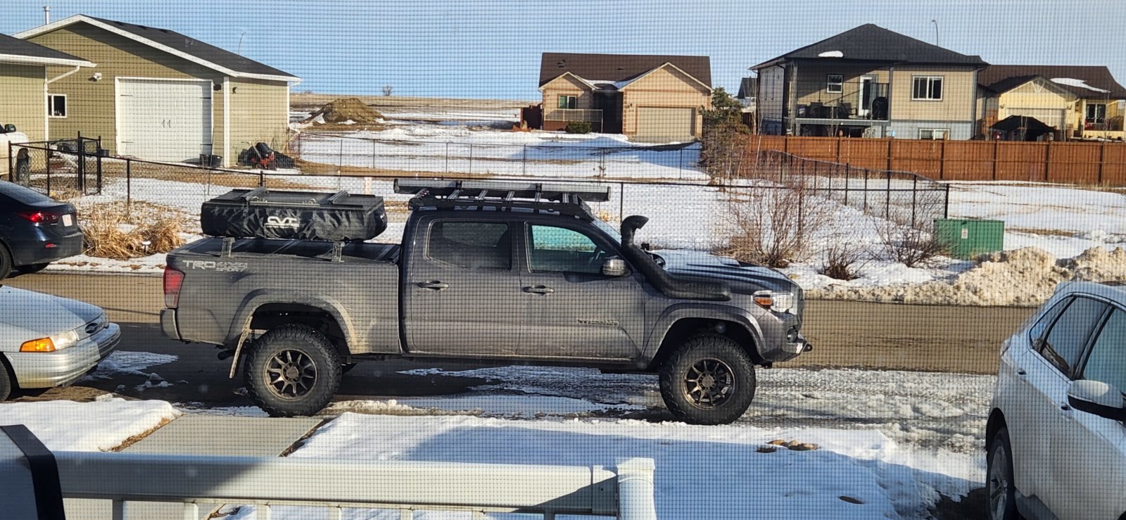

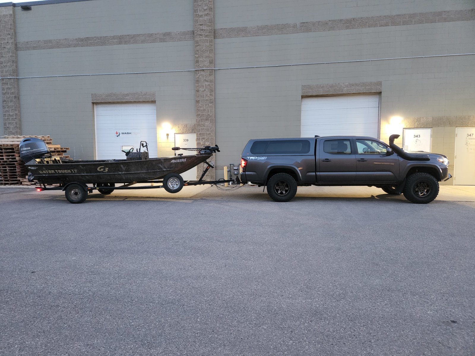

    I would suggest leafs. I had a leer 100xl and tow 17ft G3 jet with Dakar medium leafs and its not bad if empty you get any amount of gear to go with a longer trip and my nose was sky high.
    I'm in the process of putting on dobinsons 112's on to better manage camp weight and towing.
    Air bags are a very good option aswell for varying load weight but i didn't want to interfere with suspension travel and have an additional point of failure.
    It doesn't take much to sag out my ome mediums, first pic has recovery/tool box and some work tools its sagged to just past level.
    Second pic is completely empty including spare gained back 2" in the rear and dropped the front .5" Truck drives much better when there is some good rake present.
