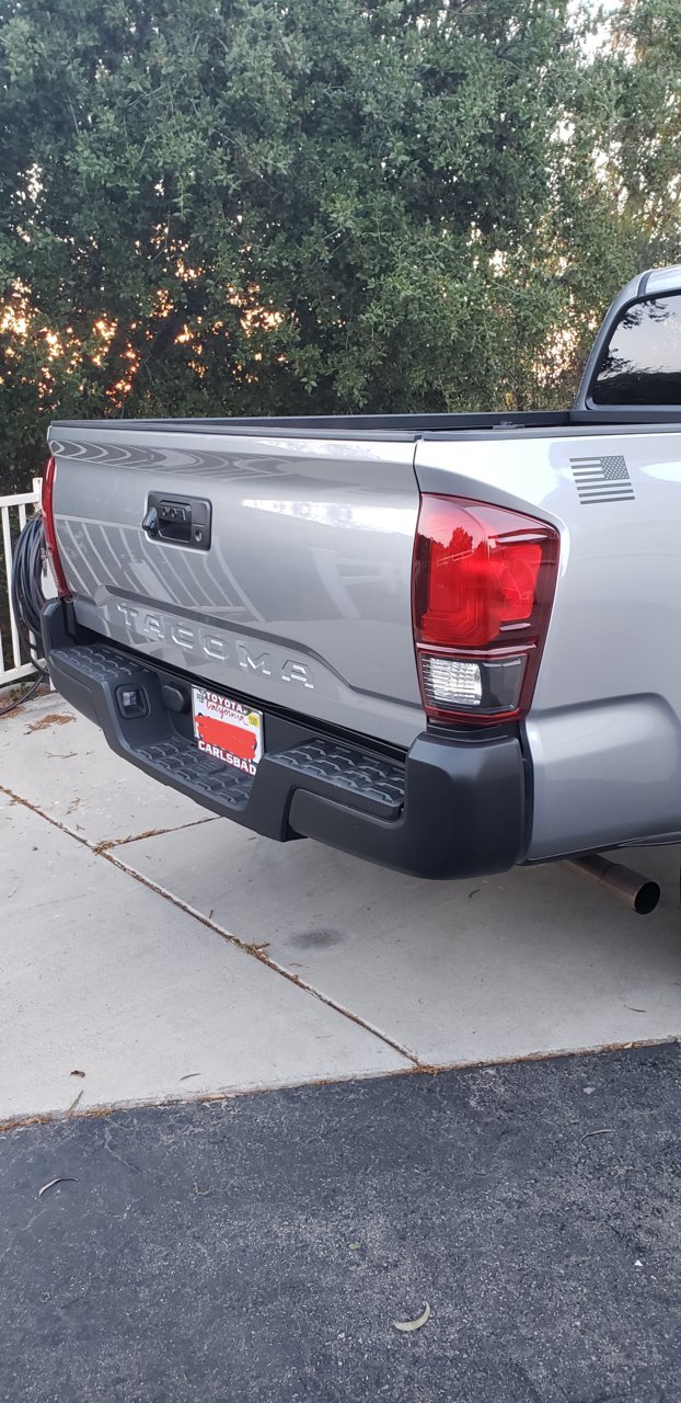

    I do not have the wiring, so I will need that as well. And as far as the ball goes, yeah, it would be too high. I may not be the most intelligent when it comes to car/truck stuff but I do know how a trailer should look attached to the back and that would put it much too high. 20190417_191812.jpg 20190417_191812.jpg

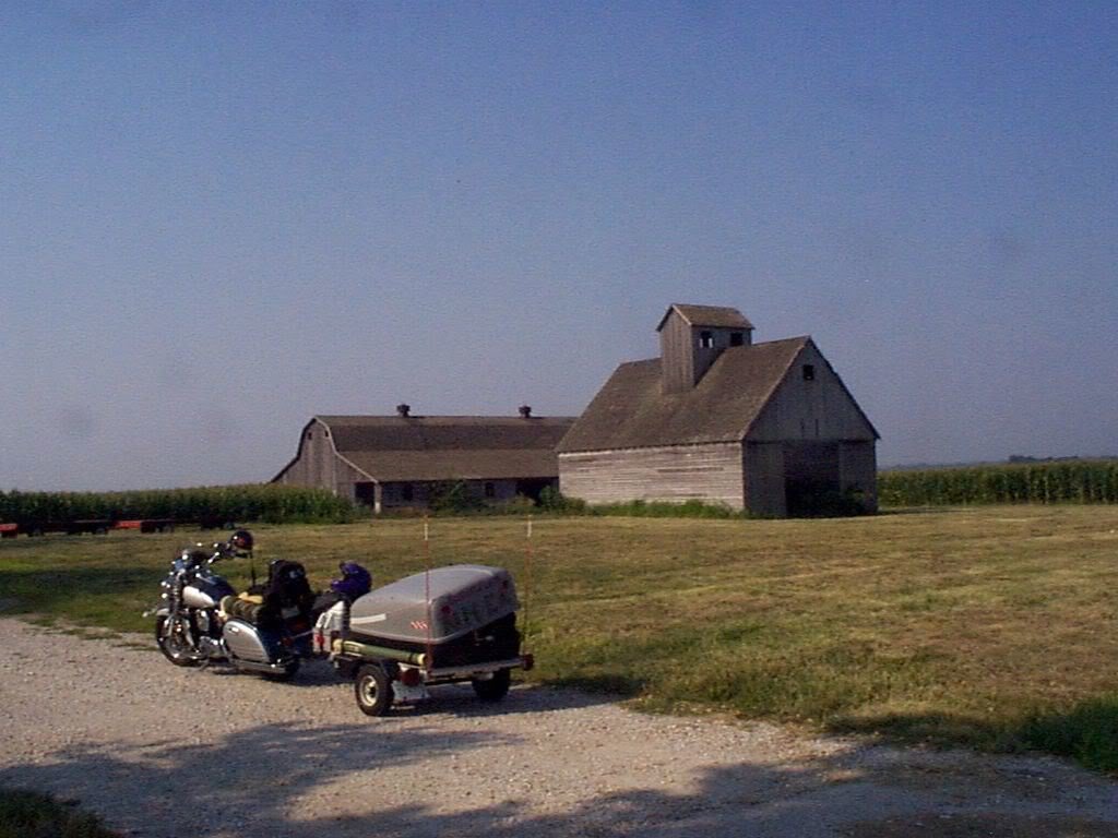

    @Lobster_Taco, You would be surprised at how many males have no clue about trailing, angles, tongue weight, loading, and how a load is secured, and etc etc. If anyone here knew I expect they would have said so. There are always 25 guys willing to screw in a light bulb, but it only really takes one. At my present age I have hailed a few trailers and even lost a few trailers, but I learned the most pulling this trailer from NH to Cal and back going the long way 24,000 miles .KSfarmhs.jpg

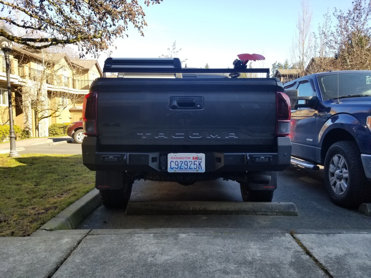

    lol you and i both trying to get rid of our seattle area tow hitches...what bumper did you end up getting?

    RCI hidden hitch...

    Looks good! Looks like we also have the same mudflaps too. But I haven't remounted mine on my high clearance yet since I need to drill into it to mount it. There's a recycling event in my area next month and I'll probably toss it there along with the rest of my stock bumper parts if no one wants my hitch soon...
