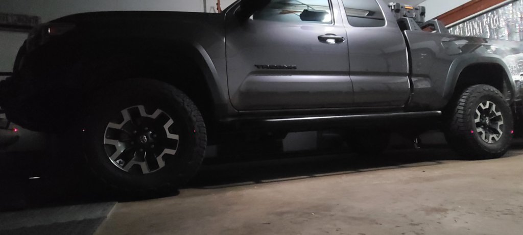

    It's not as tricky as it seems.
    I watch the angles of the ubj and lbj when doing caster 1st. camber 2nd. (you can use a level for camber).
    For toe. Park your truck and make sure the steering wheel is straight. Turn off the truck and make sure steering wheel is locked.
    You can then look or use a laser pointer from the back tire and tell where your toe is.
    Loosen the jam nut on the tie rod and adjust accordingly.
    Edit: You can see I have a laser pointer in front of the front tire. When lined up the laser will brush all 4 edges of the tire. Seen as a red dot. 2 on ea. tire.20250613_180407.jpg
