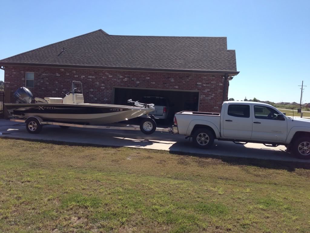

    i have a 20' boat weighing in at 3000-3200lbs with trailer, gear and gas. The truck can tow it fairly well but the rear end sags a lot. the trailer sits level when on the hitch but the truck will sag 2-3". Should I get a hitch with a greater rise to lift some weight off the rear axle or should i look into a WD hitch? I see guys towing 3000-4000lb boats/campers and their trucks are more level than mine.
    ** I do have 5100's set to .85" in the front but the rear is still a 1/2" higher when it is unloaded. I realize this will increase the angle but it still seems a little much

    The Tacoma's very soft suspensions so that they can flex off road. In return you get soft springs that sag as soon as you put a set of golf clubs in the bed. With that much weight I think you should get WD hitch just so you can avoid your headlights blinding oncoming cars.

    You want a little 'sag' for towing (tonque weight), but not that much.
    You probably have the lame OEM 3 leaf pak that came with these trucks from the factory. There's an OEM TSB 4 leaf pak that exists..... If you can find someone who has a set of these who's willing to sell for cheap - you should be OK with those.
    Otherwise, you'll need some help in the rear - better leaf pak, AAL (I'm not a fan of AAL's for towing), or air bags or something.

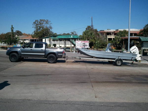

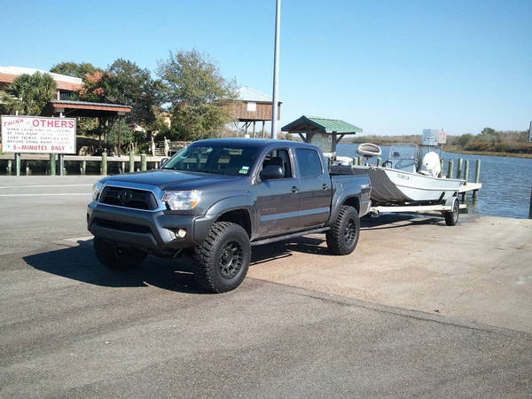

    This is me towing my friends heavy trailer made for a larger boat and his aluminum boat. I have the 3 leaf pack Icon's in the rear. I was super impressed! [​IMG][​IMG]
