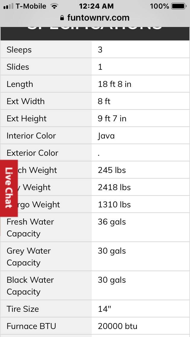

    I have a 2009 V6 4.0 access cab with towing package. I'm buying a 2014 R-Pod 177 which weighs about 2400 lbs and is 18' long. I'm driving from Oregon to Arkansas as part of a move. We plan on 12 hour days driving as we are moving 8 dogs and want to keep the trip short. I've never pulled an RV before. I'm getting a brake controller.
    Do I need or really want a WDH?
    I don't want to spend the money unnecessarily (the cost of the R-Pod was forced upon me because of the move), but I do want a safe and comfortable drive. I've never towed before, so I don't really know what's involved in the WDH. I've watched several youtubes about how to install. I've read comments that it make the drive nicer.
    I'm assuming once I get back to normal use without the R-Pod, meaning using my truck for shopping and hauling loads in the bed, I can disassemble the WDH, but then it needs to be reinstalled every time I want to use the R-Pod, perhaps with less difficulty that the initial install.
    So without any knowledge or experience, what should I do, considering cost, hassle, comfort and practicality?
