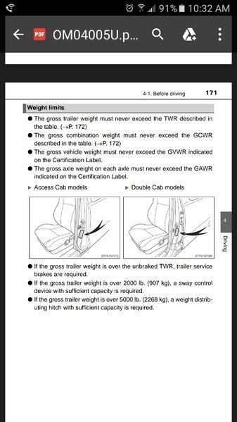

    This Is from the 3rd gen owners manual.
    recommendation for WDH <=5000lbs.
    I tow 3500lb trailer with tounge weight around 300lb, somewhat regularly and can say the WDH is a nice improvment. Even with the smaller trailer it reduces driver fatigue and allows for a more enjoyable towing expierence.
    *Edit* I'll also add your trailer can be too little for a WDH. Consider your pulling a near capacity expo trailer with a 1500 lb rated axle. You also also carry tons of gear in your truck plus a bed rack ect, ect. A WDH distributes weight through the trailer and TV so you could actually overload the small trailer due the increased load of the TV.
