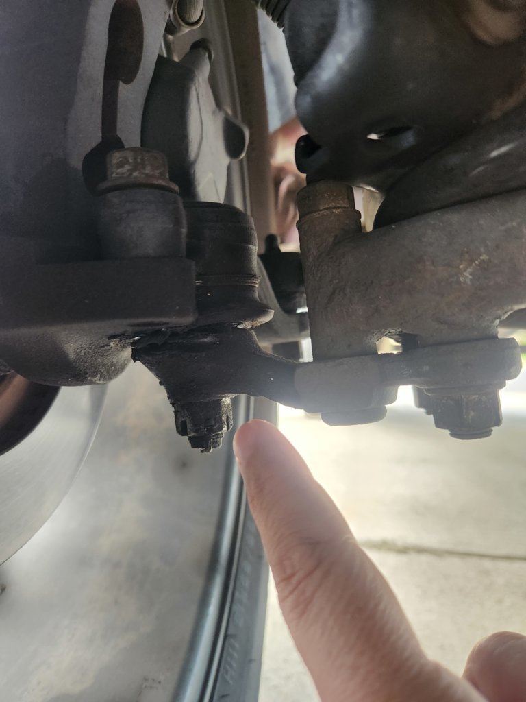

    What are you pointing at in the photo? The leaking ball joint? Probably just need to replace the ball joint in that case.

    Can someone post a link to the part I'm pointing at. Does it look bad?20250902_115053.jpg

    You can't tell from looking at it as much as the play it has up and down in the ball area. ANY movement up and down is grounds to replace it. Replace the bolts to the hub.

    Those are the older style joints that were upside down and the weight of the vehicle is always trying to force the joint apart. A little grease coming out doesnt always mean a problem but I'd be seriously considering replacement just due to age
    Manufacturers have since gotten aways from that design and most lower ball-joints are now flipped over so the weight is pushing it together instead of apart

    Thanks I know now that it's a ball joint. I do some of the work myself. I had a shop redo the front end 2 years ago. They did all the ball joints. It's just making a creaking sound on that side when I pull up my driveway or going slow over bumps. That's all that looking bad under there.

    The ball joint is not in the lower control arm in 1st gens. Rather, it's in the steering stop bracket. No way to tell if the joint is bad by just looking at it, because the boot is open at the bottom. Jack up the truck until the tire is just off the ground. Put a pry bar under the tire and pry up. Check for play in that joint. Alternatively just replace it because it's leaking and has no regreasing provisions.

    I'm just gonna say this first: If you are unsure, take the truck to a shop. There is a ton of info to be shared on this site and other forums, but we can't make decisions for you.
    Usually creaking would imply bushings. I would suggest getting some silicone or teflon dry lubricant and spray one bushing at a time. If the creaking stops, you know what the problem was, rather than spraying everything all at once.

    Is it just me or does that bolt on the left side not look all the way torqued down?

    I agree it does look like the bolt is slightly backed out

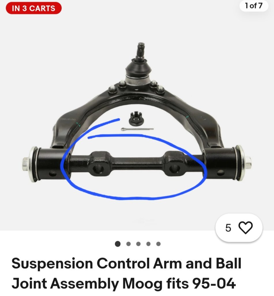

    What are the bolt that go here called? I cant find them anywhere. And yes those bolts are tight they just look like that.
