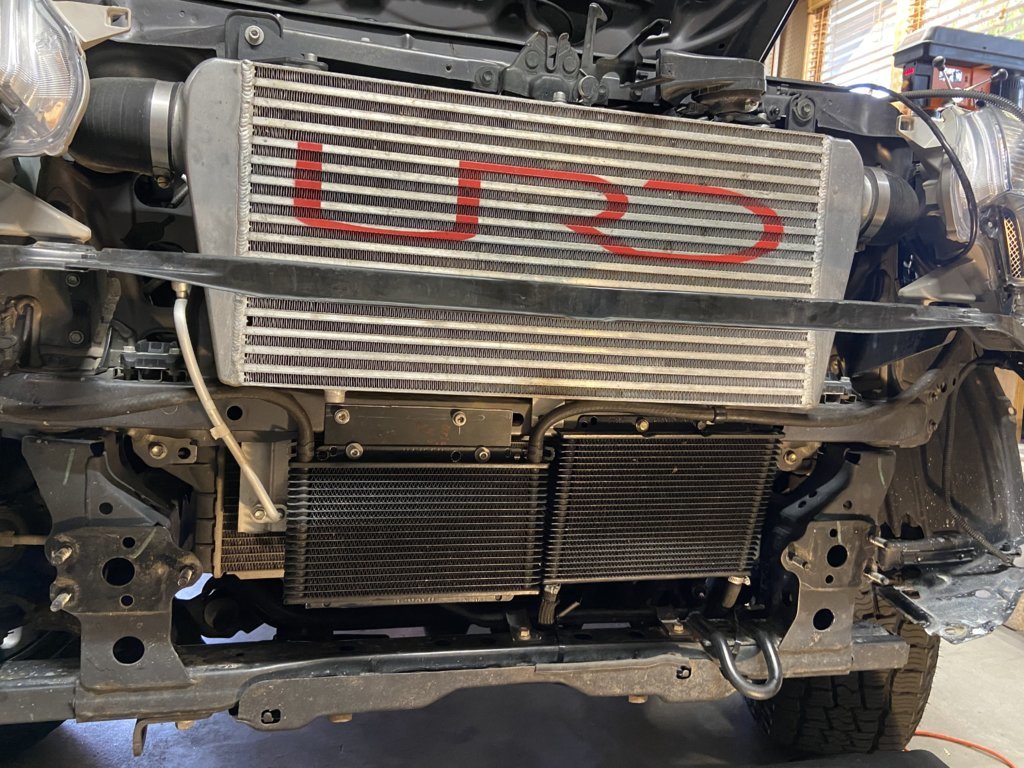

    I’ve got two years of towing experience in the Colorado mountains up to 12,000 feet. I’m pulling a 3000 pound Colman which, is about as aerodynamic as a parachute. I believe my max loaded is about 4000lbs. We go to all parts of the state without worry whether it’s hot or not and my temps are perfect! I’ve got the 2.7L but added a supercharger and it dynos at 250TQ and 240HP at the rear wheels. I added a large trans cooler and the SC has it’s own oil cooler. My engine coolant temps never exceed everyday temps of about 200 to 210º. The Trans temps range from 140º in cold weather to a high of 218º on a very hot day and long 7º climb. I don’t have any concern for the oil temperatures and I base this on coolant temps and the condition of the oil at oil change time.
    I don’t have any difficulty pulling on long, steep grades, but my one wish would be for the 5-speed manual transmission, as my four cylinder came with the four-speed automatic.
    Let me know if you have any questions about towing here. We are in Centennial, CO, just south of Denver.
