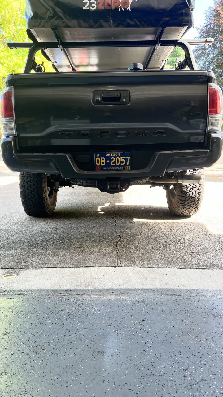

    Just walked out to my truck and noticed that there was a significant lean, the left rear is 1.75” lower than the right rear.
    I haven’t been towing or hauling heavy loads (though I do have a RTT). I haven’t really even off-roaded this truck all that much (and haven’t for over a year.
    Do leaf springs simply fail like this? Only 32,000 miles.

    Not enough information. Climb under the truck and take pictures of the suspension and post them up. Something can be broken, or your load can be unbalanced.

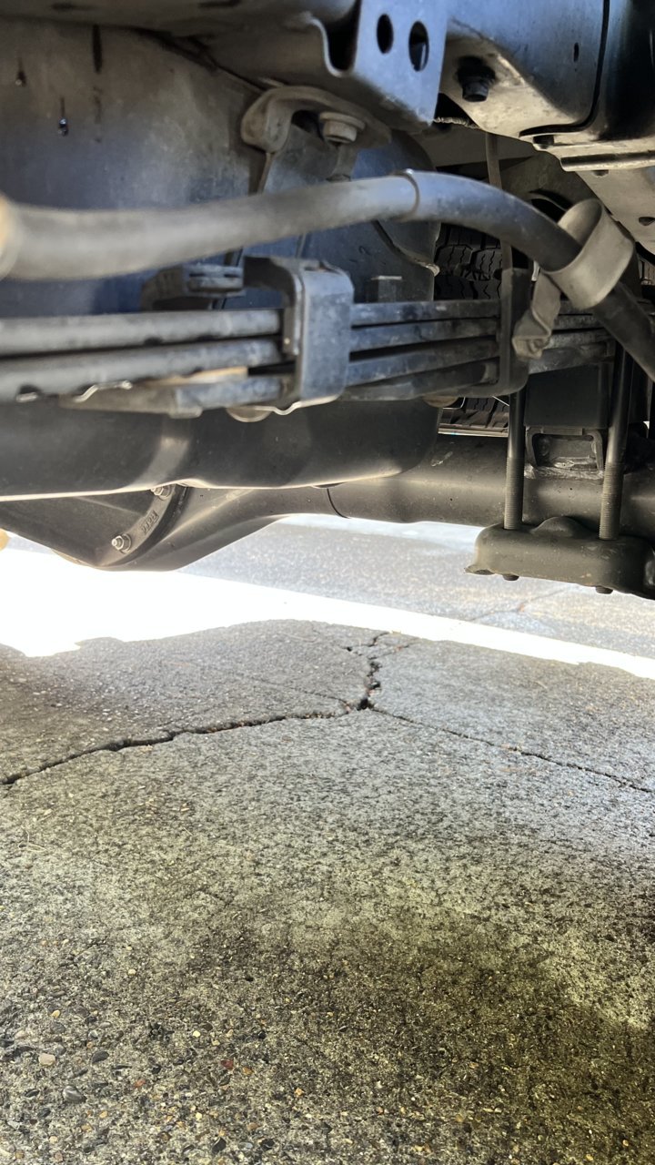

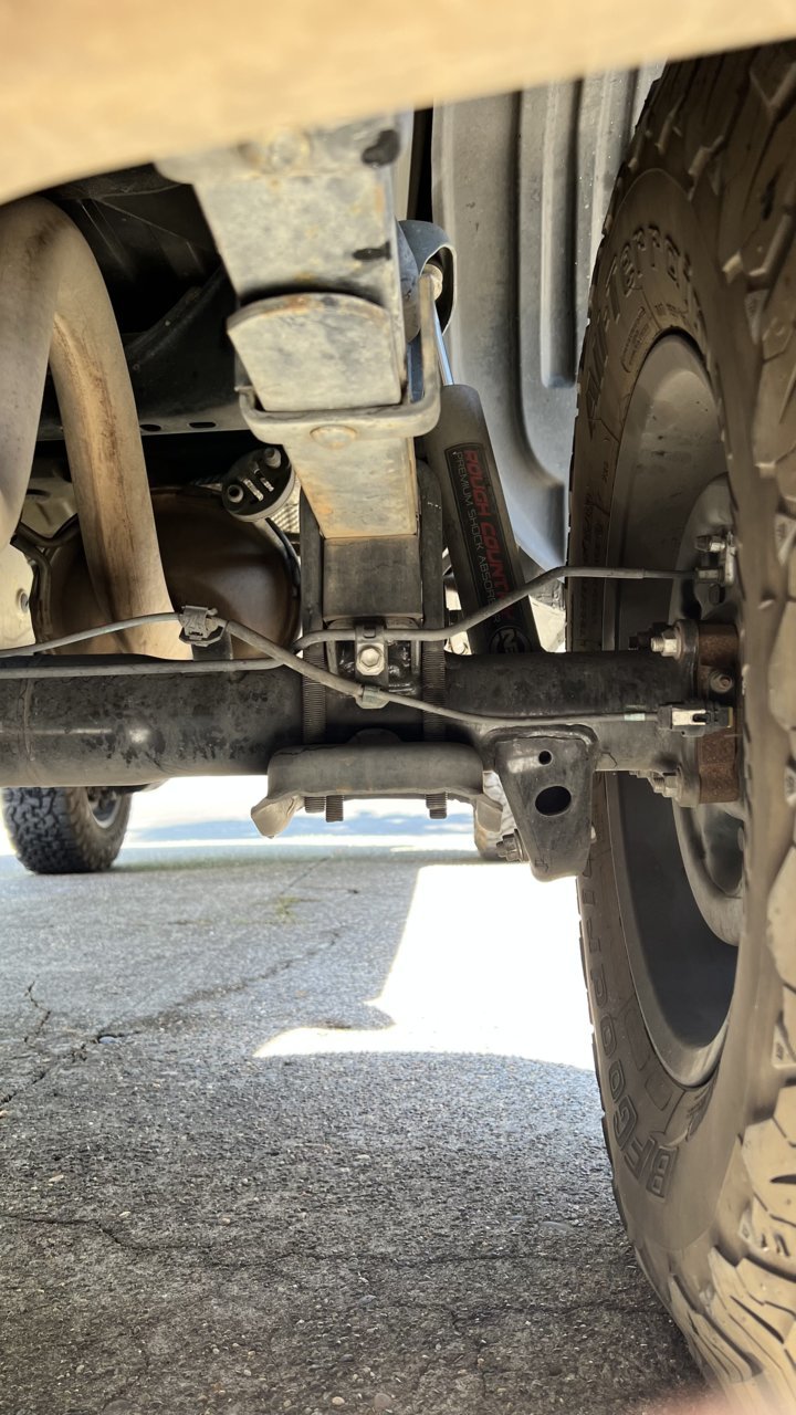

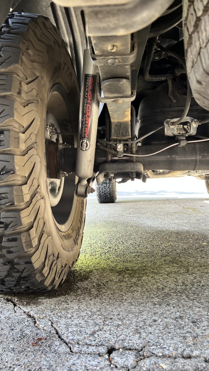

    Left rear, from the back and front, right rear from the back. It looks to me like the front of the left leaf dips down.
    To answer the question about the front; everything is even/same on both sides.
    I do have blocks under the rear springs & had planned on going with a better option later, just wasn’t quite ready.

    Nothings seems broken from a visual inspection - just seem to be sagging on the left rear

    Those springs have not failed, they’re loaded, and the OE springs seem to be more geared to ride comfort, than actually hauling anything. Blocks don’t help things either.

    Id put some sort of a add a leaf of leaf pack like Deaver. so your truck can actually bounce up and down a bit. Is the truck bottoming out easily in the rear? Looks like the shocks are doing all the work because of your blocks.

    I would check the droop and make sure one of the shocks isn't bound up and preventing full extension due to some internal binding. Drive each side of the rear up on a curb, separately, and make sure you have full articulation in both directions.
