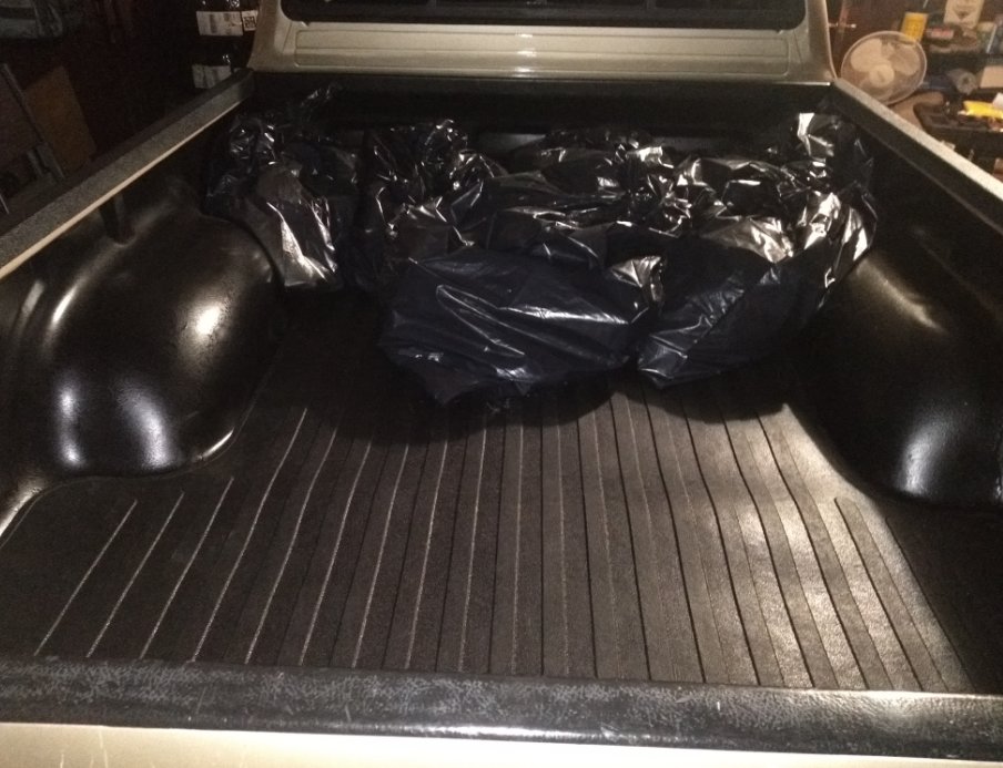

    Yesterday, I added 300 lbs of sand bags to the back. It really helps the ride and leveled out the rear while I wait for the springs to settle.
    04TRDV6[QUOTED] likes this.
