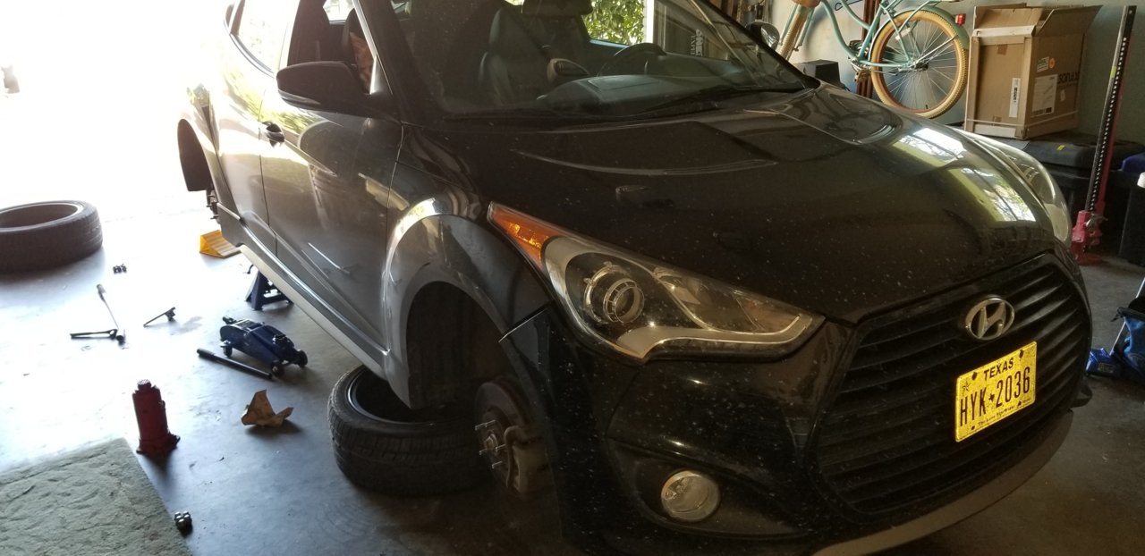

    8 am: hitched my camper to the truck and pulled both out of the garage so I could have space to work. Rolled the veloster into the garage and laid out parts. Dug out the smallest of my bottle jacks and also the farm jack, realized that none of them are small enough to reach underneath this tiny car. Fuck.
    9am: AutoZone opens. Drive tacoma to the parts store, try to find a spot long enough to park the camper. Buy a 30 dollar floor jack.
    9:15- thirty dollar floor jack already has problems with its cheapass caster wheels. No matter. Car is on stands and wheels are off. Pull front calipers. Take off front rotor. Realize that these parts don't even remotely look like the parts recieved from Rock Auto. Replacements are almost half the size of the fronts, and half as thick.
    9:30 - getting harder to find large enough parking spot at advance auto parts to accommodate the camper. Bring brake pads into store. Not in stock. Go across the street to OReilleys. Also not in stock. Drive 15 minutes away to the next closest Advanced. In stock. 100 dollars for a set of four pads.
    Weird story about Hyundai Velosters; different trims use one of three different size brakes. Apparently the middle trim (turbo but not turbo-rs) uses the largest rotors.
    At least I had the foresight to look at the calipers. The rears use the socket unwinder tool that I bought earlier, but the fronts need a simple compression vise. Fuck this weird ass car. 10 bucks for the cheapest caliper squeezer on the shelf. Back to the garage.

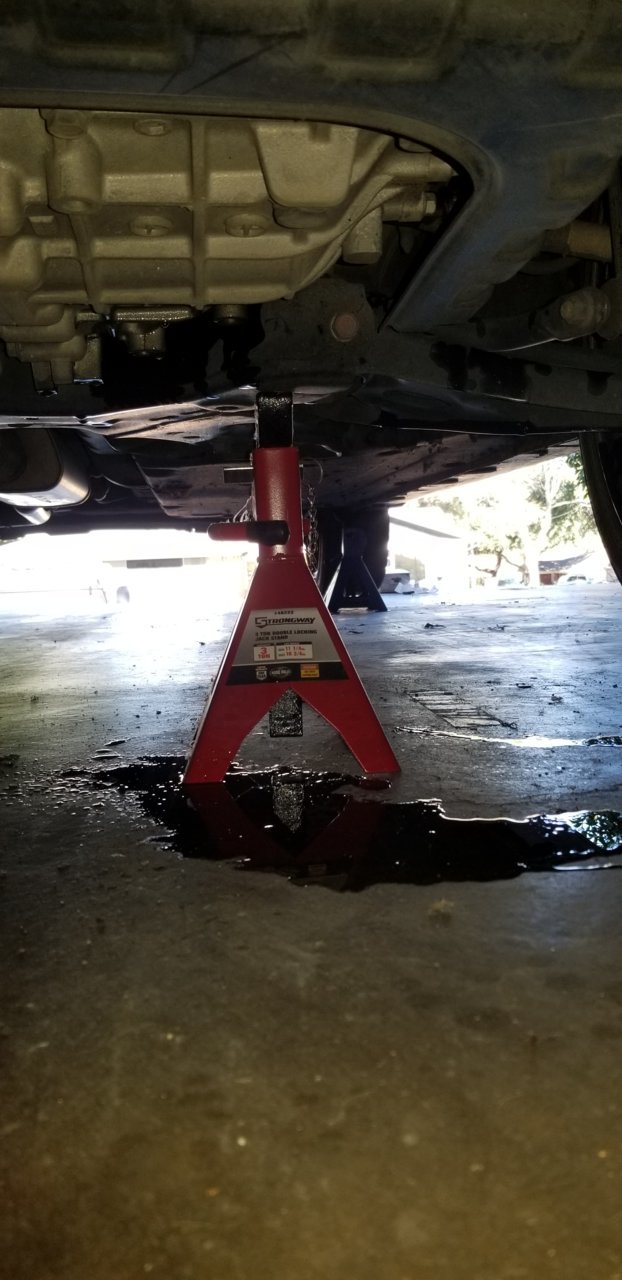

    10:00- slap pads. Easy and done. Pop the hood to swap the air filter. Notice a growing puddle of mystery fluid dribbling down the trans, right above the cross member that I used as my jack stand point. Temporarily die from panic.

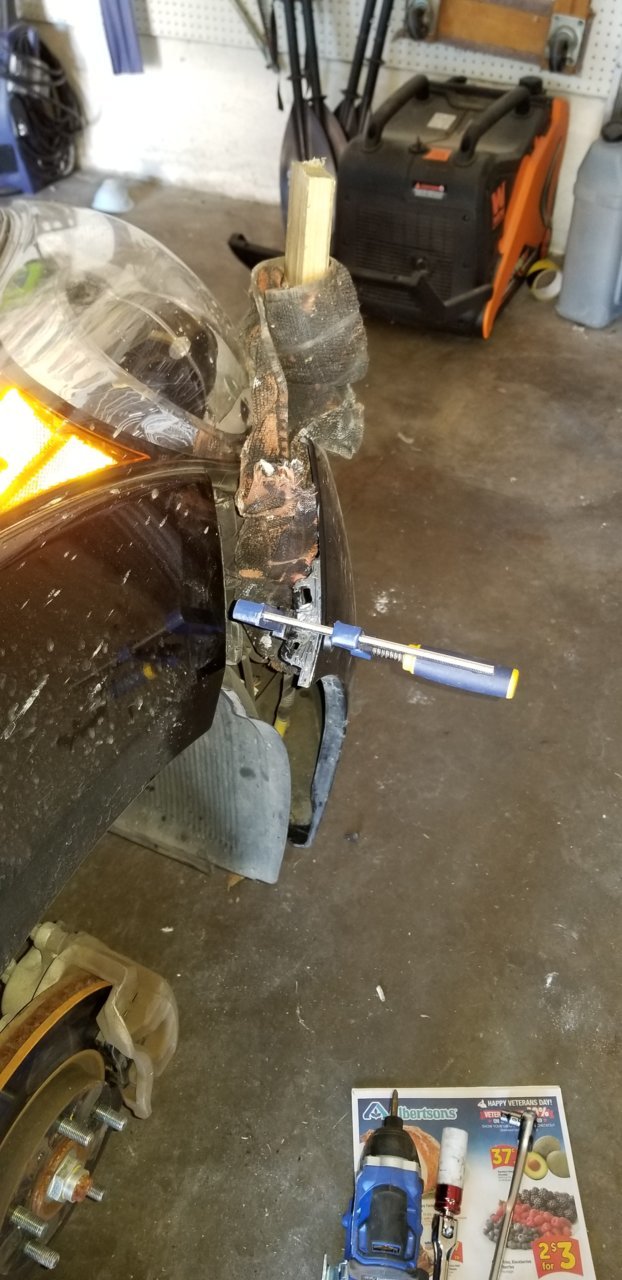

    10:15 - slowly come to the realization that maybe, just maybe backing off four calipers might cause the reservoir to run over. Take a minute to recover from temporary death. Start to put wheels back on. Notice the bumper is loose. Find remnants of broken clip still bolted to inner fender.:goingcrazy:
    11:00 - off to ace hardware! One tube of marine JB weld to reattach broken bumper clip. Let that cure. Start the car and pump the brakes back into position. Pedal feels good, spilt fluid smells bad. Oh well. While car is running fiddle with AC controls to turn them off. Notice blower doesn't run unless it's on the highest setting.
