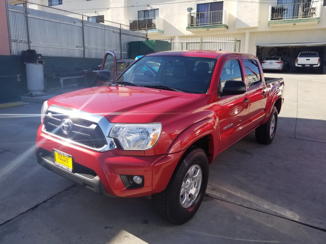

  19. Apr 15, 2019 at 7:46 AM
    #19
    kazuaki
    kazuaki [OP] Well-Known Member
    Apr 9, 2019
    #289611
    54
    2015 Tacoma DCSB 4x4 TRD Off Road
    Well, we picked up this truck over the weekend. 2015 DCSB TRD Off Road in Barcelona Red. Its in great condition overall. The tires in it looked cracked and a bit old, but the price was decent. I was uneducated on tire date codes. I've since researched it and discovered the tires have a date code of "3900", so they were made in 2000! I'm pretty pissed about that, so it's time to shop for tires. Anyway, thanks for all the input.
    henryp and DavesTaco68 like this.
  20. Apr 15, 2019 at 8:04 AM
    #20
    Muddinfun
    Muddinfun Well-Known Member
    Apr 17, 2017
    #216500
    7,489
    Good lookin truck. Congrats.
    If that were my truck, I would put 265/75-16 tires on it.
