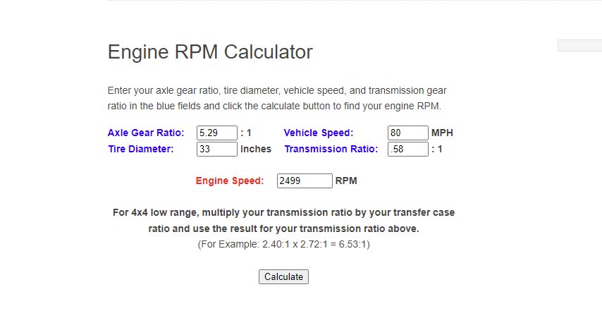

    Talk to them about gear ratios. 5.29 may be a little short.

    Different strokes for different folks but highway performance/efficiency struggles too much IMO.
    https://www.crawlpedia.com/rpm_gear_calculator.htm

    Thanks again. According to what I have read I should be at about 2200 rpm at 70 mph in 6th gear with the 285’s. Does that sound about right? It’s much higher than stock but I can live with that. I wouldn’t want it to be higher than 2200 though.
