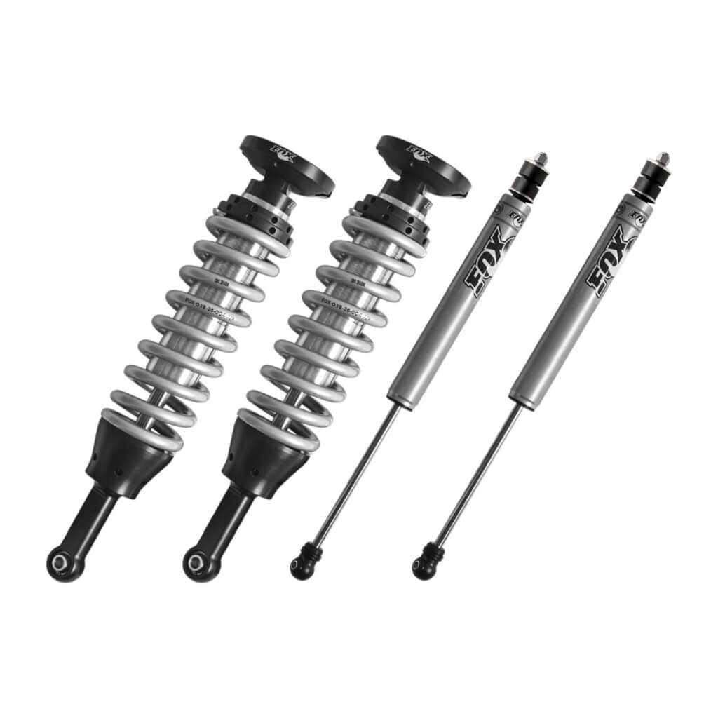

    Trying to get these
    FOX 2.5 FACTORY IFP 0-3″ LIFT SHOCKS 2005-2020 TOYOTA TACOMA 4WD and wanna know if I can use the stock 2019 Tacoma uca?

    I'm pretty certain you do regardless of the lift. The stock UCAs will hit the 3" coil springs at full droop.

    Yes you do. The amount of lift you set it at isn't as important (as far as clearance) because where you will hit is with the droop and that doesn't change if you have it at 0" or 3". Where the amount of lift matters is as you go up, you will require more caster to get it back to "normal".

    Not necessarily. UCA will help you achieve full extension, especially if your coilover is extended and will help you achieve desired alignment specs.
