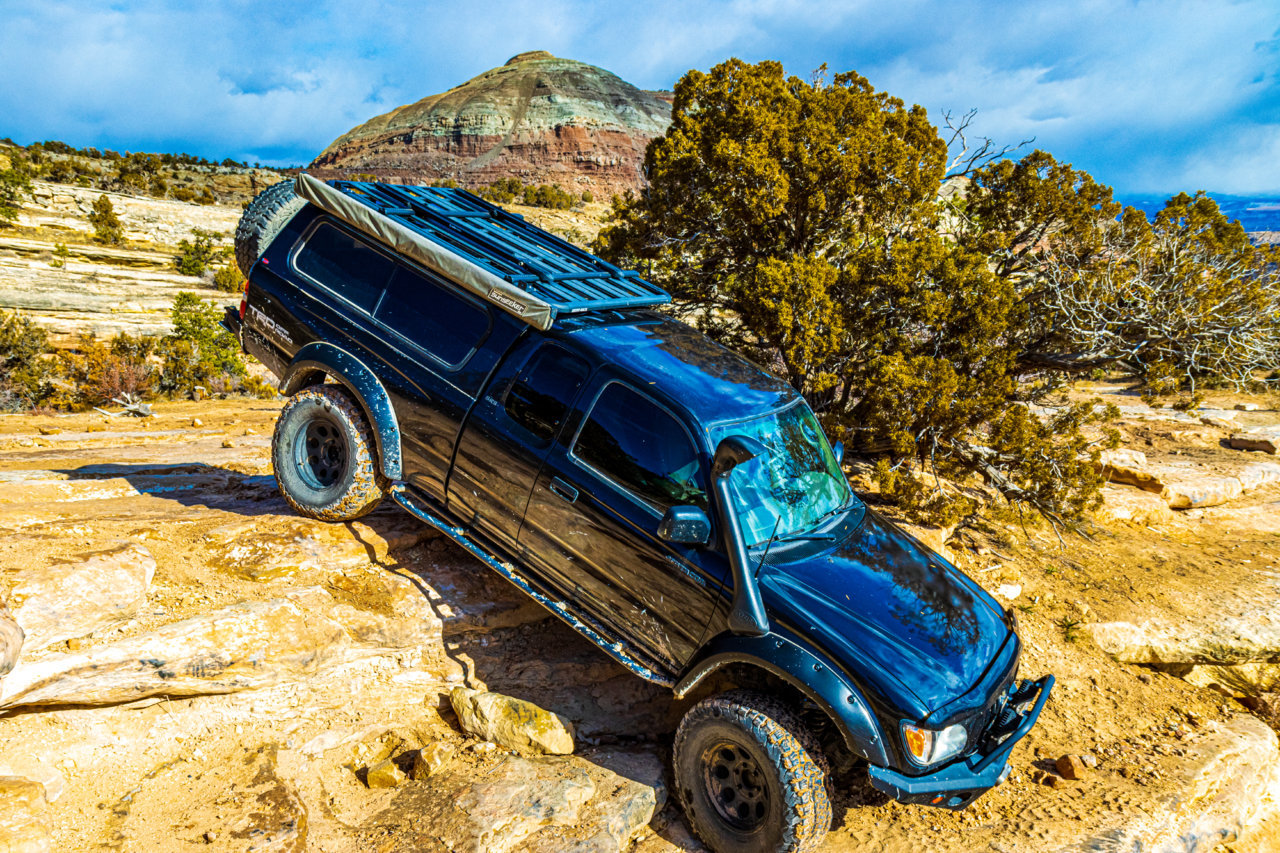

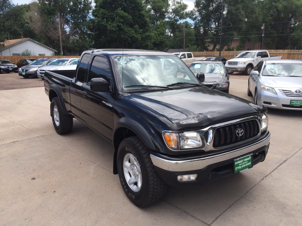

    Fair enough. I went from this:32CE1C24-4DA0-449A-B961-FAD025474E77.jpg
    to this:
    After joining TW
    Plus recovery gear, and I frequently carry camping gear or other heavy crap. It adds up quick.
