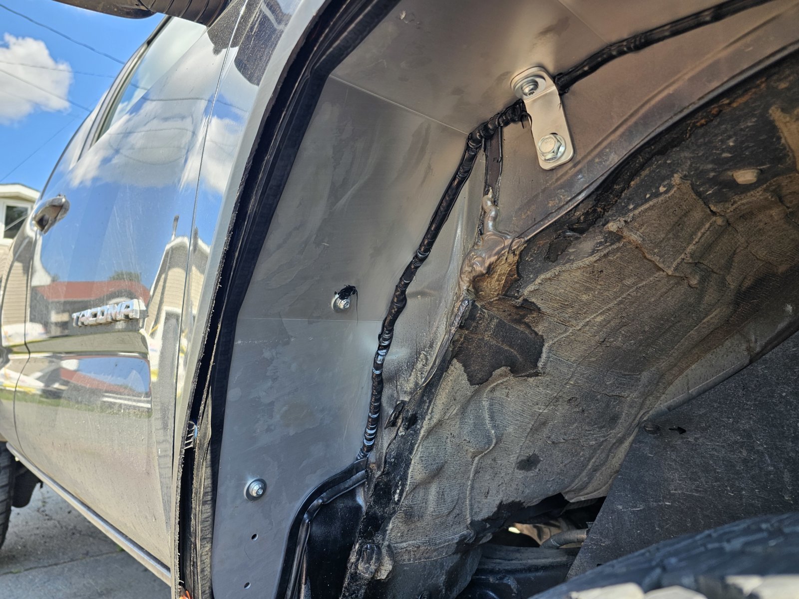

    The only thing you're missing is replacement inner fender liners. When you do the fender/fender flare trim you won't be able to re-use those liners, and leaving that area open allows water and whatever else to get thrown into that cavity and could possibly seep into the cab. There's a member on here who makes some out of ABS, and C4 makes a great aluminum kit (that's what I used).

    i went with the c4 liners aswell. clean look.
