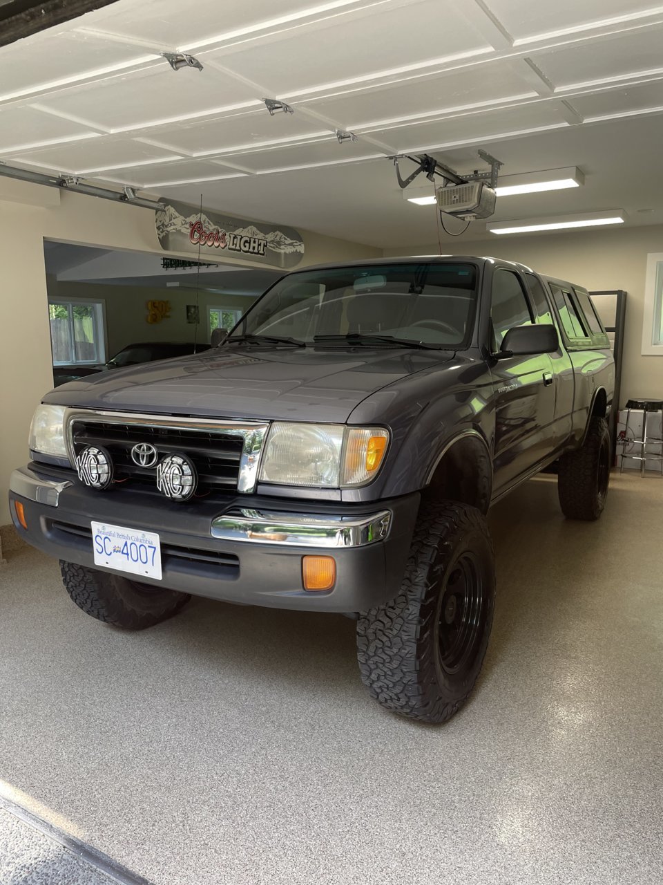

    Currently running a 3.4 v6 manual with 31's, 3inch toytec/bilstein 5125 lift. Ko2's are wearing out, thinking of replacing with 33's. Will I need to re-gear? Also, will I experience any rub at 3 inches? Don't want to trim.
